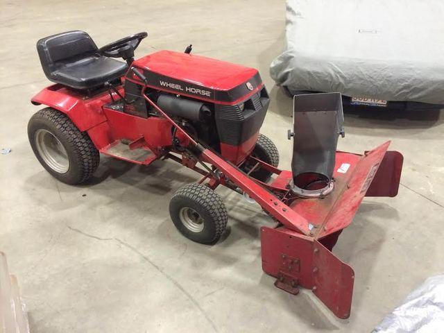

Bigpat5123 28 #1 Posted November 21, 2016 Found a parts blower for short money to convert my short chute that I reconditioned last year into a tall chute. Very easy to change over. I ordered a new chute gear ring and retainers as there was too much play in the chute to rotate smoothly. Also got a set of wheel weights with the deal, 50# a piece. 10 Share this post Link to post Share on other sites

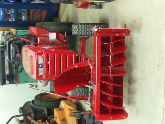

moe1965 774 #2 Posted November 22, 2016 L99ks like you are ready . I did a total rebuild. my first wheel horse project both tractor and blower here in North East Ohio . bring it on 3 Share this post Link to post Share on other sites
JERSEYHAWG / Glenn 4,589 #3 Posted November 22, 2016 Pat, good deal. And Moe, nice clean job. Glenn Share this post Link to post Share on other sites

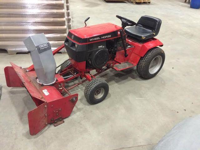

Bigpat5123 28 #9 Posted February 20, 2018 Pete, unless you have a donor blower it is hard to upgrade. I made a custom chute that worked quite well that I would sell. It has everything you need to attach to your short chute and can be modified however you want. Here is a picture for reference. Let me know. Share this post Link to post Share on other sites
Sarge 3,473 #10 Posted February 20, 2018 As a retired Millwright - I'm sure with some drawings of both model blowers you could fabricate the parts needed for the conversion - given access to the tools needed. Biggest difference in those models was the addition of a bolt-on cutting edge designed into the housing's bottom - that housing is quite a bit stiffer, too. Being able to replace the area that scrapes the ground was the way all of them should have been built. I think there were also some changes done to the auger design itself - not dead sure on that one but they do throw the material a lot more efficiently. Most folks here upgrade all the various single stage models with rubber paddles or added metal to minimize the clearance between the paddle section and the housing - makes a huge difference. I have an older and smaller model box blower - rubber paddles on it gave it around a 40'+ throwing distance, much better than stock and less prone to plugging it up with wetter material. Sarge Share this post Link to post Share on other sites
Bigpat5123 28 #11 Posted February 20, 2018 Sarge, The biggest difference and advantage to the tall chute was the chute assembly which includes the rotation mechanism. The new tall chute blowers have a worm gear and teeth on the bottom of the chute. This is a much different setup than the old cable style. This part is not so easily reproduced. Of course something else could be used to make rotation better if you have the time, materials and expertise. Good Luck and have fun! Share this post Link to post Share on other sites

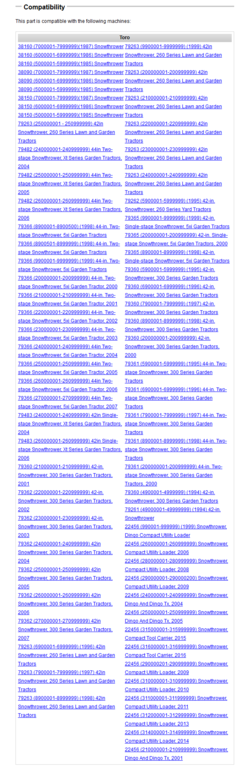

Sarge 3,473 #17 Posted February 21, 2018 This kit is interesting, looks like the cost for the 26-1110 kit is just over $100 - look into the compatibility list for tractors , goes all the way back to the 300 series , 44" 2-stage throwers and even the Xi series equipment. https://www.ereplacementparts.com/chuteextender-p-689990.html Sarge Share this post Link to post Share on other sites
