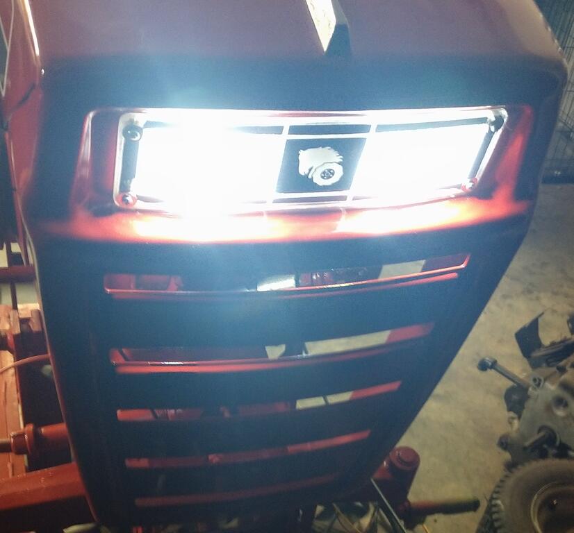

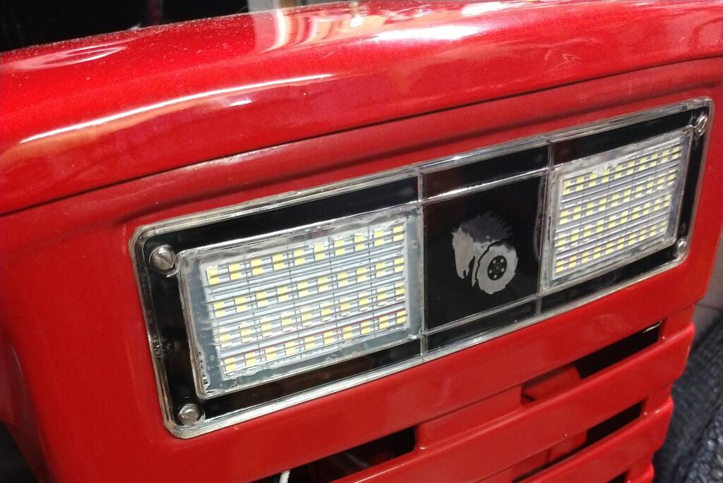

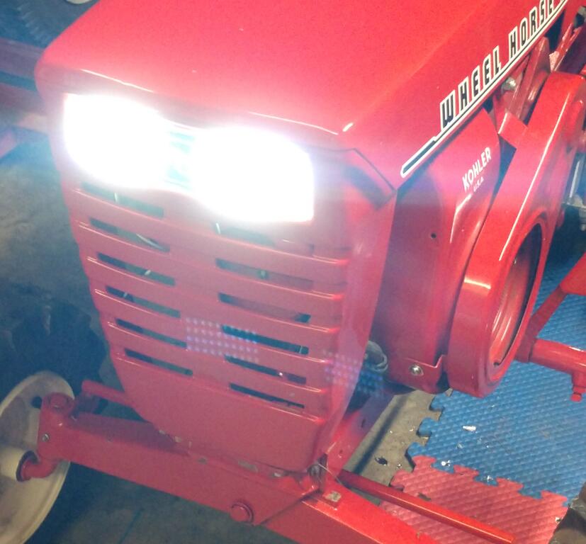

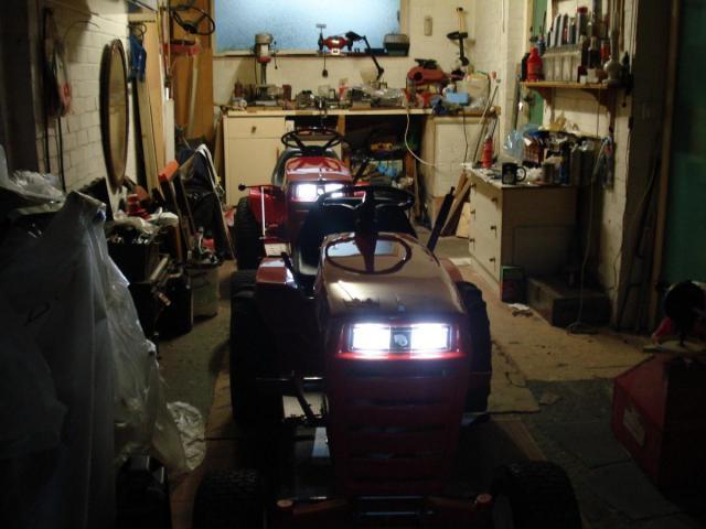

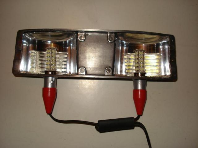

Anglo Traction 761 #12 Posted November 26, 2016 I put LEDs in about 4 years ago on both my Tractors. Fit straight into the original 1156 sockets. 68 SMD LEDs. The Buckets had Self Adhesive Chrome Mylar and S A polished Ali foil to cover the old vents- Much improved output. Also fitted LED bulbs in the Rear Lights using existing holders. 6 1 Share this post Link to post Share on other sites

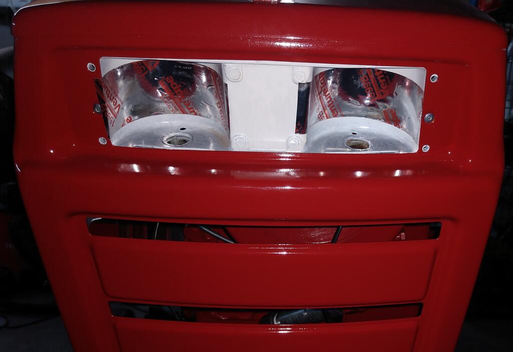

55reasons 171 #14 Posted May 21, 2020 On 11/26/2016 at 2:24 PM, Anglo Traction said: I put LEDs in about 4 years ago on both my Tractors. Fit straight into the original 1156 sockets. 68 SMD LEDs. The Buckets had Self Adhesive Chrome Mylar and S A polished Ali foil to cover the old vents- Much improved output. Also fitted LED bulbs in the Rear Lights using existing holders. I just saw this as I was getting ready to package my headlight bucket to have it chromed. I read your post and googled “self adhesive chrome mylar” and got nothing but chrome vinyl. I googled “S A polished Ali foil” and got no results at all. Mind if I ask you for some links to the products you used, and how well it has held up ? 1 Share this post Link to post Share on other sites

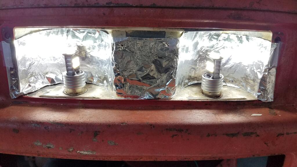

Inspectorjoe 473 #16 Posted December 8, 2021 I replaced the 1156's in my '73 14 Automatic with a a $20 pair of LED's from iSaveTractors. Although they don't direct the light directly toward the front, they're a huge improvement over the incandescents they replaced. I lined the bucket with aluminum foil. I'm cheap. 1 3 Share this post Link to post Share on other sites
Maxwell-8 4,371 #17 Posted December 8, 2021 5 hours ago, Inspectorjoe said: I replaced the 1156's in my '73 14 Automatic with a a $20 pair of LED's from iSaveTractors. Although they don't direct the light directly toward the front, they're a huge improvement over the incandescents they replaced. I lined the bucket with aluminum foil. I'm cheap. Cheap great option! I use alloy foil also for a cheap exaust blanket 2 Share this post Link to post Share on other sites
Handy Don 16,595 #18 Posted December 9, 2021 19 hours ago, Inspectorjoe said: I lined the bucket with aluminum foil. I'm cheap. Cheap maybe. Inventive and clever for sure. Looks good! 1 Share this post Link to post Share on other sites

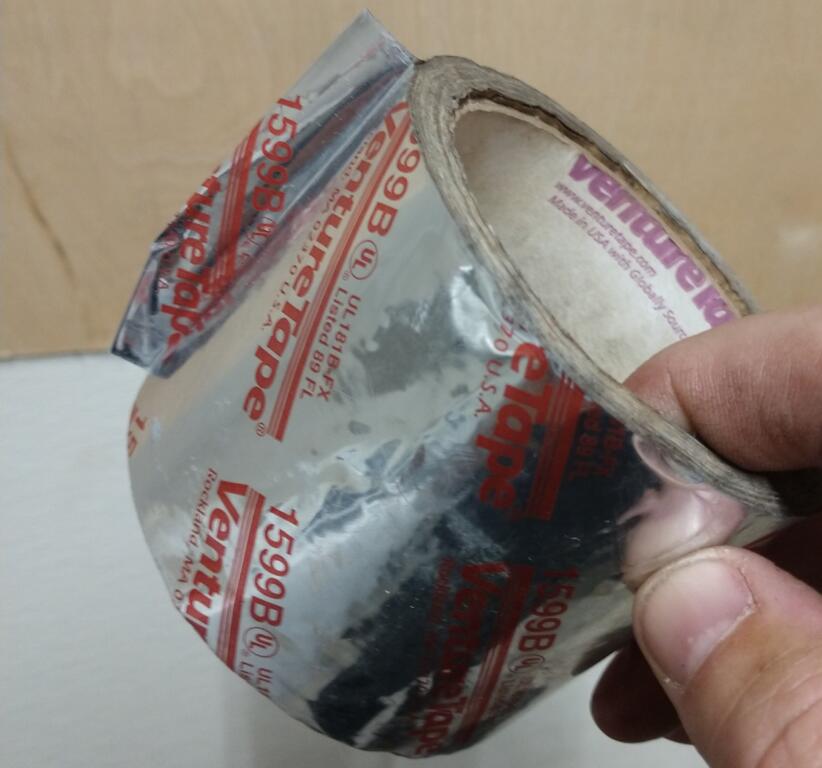

kpinnc 18,220 #19 Posted December 9, 2021 (edited) I used foil tape on the Charger bezel, and it worked OK. Edited December 9, 2021 by kpinnc 5 Share this post Link to post Share on other sites
kpinnc 18,220 #20 Posted December 9, 2021 The previous mod works, and though it is far better than original lights- this mod makes headlights actually worthwhile. I'll be putting up a thread on this shortly. 2 1 Share this post Link to post Share on other sites
