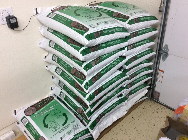

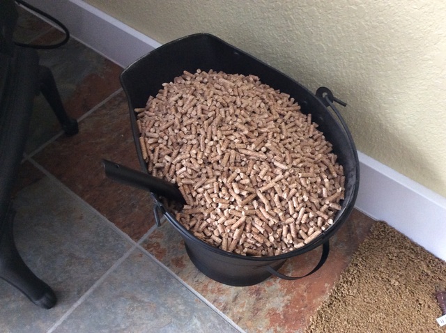

Fun Engineer 863 #29 Posted November 22, 2016 We went with a pellet stove after using a nice Vermont Castings Wood stove in our last home. I love cutting wood but it's gotten harder to do as I age and I really didn't like hand splitting the logs. So now I get my real fire fix outside in our fire pit. Here's some info in case anyone it thinking of going the pellet route. Our pellet stove is an Avalone "Arbor". It sits in the corner of our living room and heats 1380 square feet. 110 volts and a very short 3" chiminy through the side wall with 3" make up air. It saves a lot on propane every year. I use about 2 tons of pellets every year at +- $200 a ton. Probably save over $1500 on propane. I have it hooked to a programmable thermostat in the hallway to turn on at 6am and off at 11pm. Keeps the livingroom, kitchen and dining area at 70-72 and the bedrooms around 67. We used to run it 24/7 but when the power goes out it won't evacuate the smoke. If you loose power, smoke leaks out.😩 This is the main drawback to our stove so we shut it down at night and if we're going to be gone for any length of time. We keep the gas furnace set at 67 so anytime we're not home or at night the gas furnace heats the house. This helps keep some heat running through the heat runs in the crawl space which helps condition that area as well. Here's a couple of pictures of my current wood pile. Notice the lack of dirt, bark and melting snow 😝 2 Share this post Link to post Share on other sites

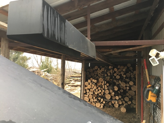

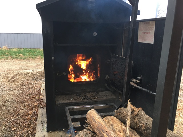

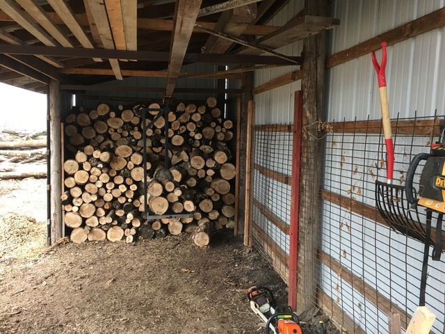

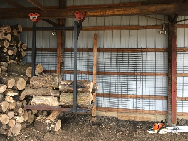

wheelhorseman 3,256 #30 Posted November 22, 2016 (edited) My stove is an outside wood boiler. It heats the house, shop and water and I have also included some pictures of my wood shed and trolley system that I made to fill the stove. Edited November 22, 2016 by wheelhorseman1000 9 Share this post Link to post Share on other sites
Ed Kennell 47,666 #31 Posted November 22, 2016 5 hours ago, wheelhorseman1000 said: My stove is an outside wood boiler. It heats the house, shop and water and I have also included some pictures of my wood shed and trolley system that I made to fill the stove. You definitely are THE wood stove man Lowell. Free heat and hot water without the smoke, dirt, ashes, bugs, and danger of fire. Gotta luv that well engineered wood transporter with the opposite corner supports for easy loading. 4 Share this post Link to post Share on other sites
elcamino/wheelhorse 9,363 #32 Posted November 22, 2016 @wheelhorseman1000Lowell how often do you have to feed that monster? Share this post Link to post Share on other sites
wheelhorseman 3,256 #33 Posted November 22, 2016 Depends on the temperature of course but if it's below 20° out twice a day and above 20° once a day and if I'm just heating the water in the summertime about once every 5 to 6 days 4 Share this post Link to post Share on other sites
DennisThornton 4,773 #34 Posted November 23, 2016 10 hours ago, wheelhorseman1000 said: My stove is an outside wood boiler. It heats the house, shop and water and I have also included some pictures of my wood shed and trolley system that I made to fill the stove. I sure like the trolley system! 2 Share this post Link to post Share on other sites
Coadster32 793 #35 Posted November 23, 2016 That whole setup is pretty sweet. A+ on the trolly system. 2 Share this post Link to post Share on other sites
