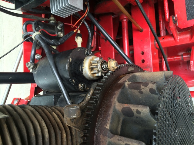

Al C. 1,474 #1 Posted November 16, 2016 The starter gear on my K341 periodically fails to engage the flywheel gear. This only happens after the engine has been running a while and is still hot. The battery is new, heavy duty, and full charged. The starter gear is clean and fully lubed. Any thoughts? 1 Share this post Link to post Share on other sites
Pollack Pete 2,273 #2 Posted November 16, 2016 Have you removed and disassembled the starter?I find that the bushings get dry,the brushes tend to stick,commutator gets a little dirty and things just don't work as they should.Take it apart,blow all the dust out,grease up the bushings,steel wool the commutator,lube the Bendix,and it will be good for another 25 years. 3 Share this post Link to post Share on other sites

Daddy Don 912 #4 Posted November 16, 2016 That is what I do to mine and it takes care of the problem. Share this post Link to post Share on other sites

oldredrider 2,553 #10 Posted November 21, 2016 One VERY important thing to know before disassembling a starter, starters REQUIRE sufficient amperage to operate properly. Poor battery connections, poor solenoid connections, poor starter connections all reduce the amperage fed to the starter. I recommend all the above be checked with an OHM meter BEFORE taking a starter apart. Cleaning and lubing a starter is relatively simple, but why waste time when that is not what was needed? If you don't own an OHM meter, get one and learn how to use it. It will become one of your best friends when troubleshooting electrical problems. 2 Share this post Link to post Share on other sites
