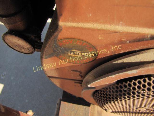

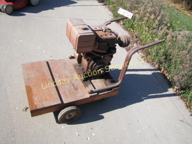

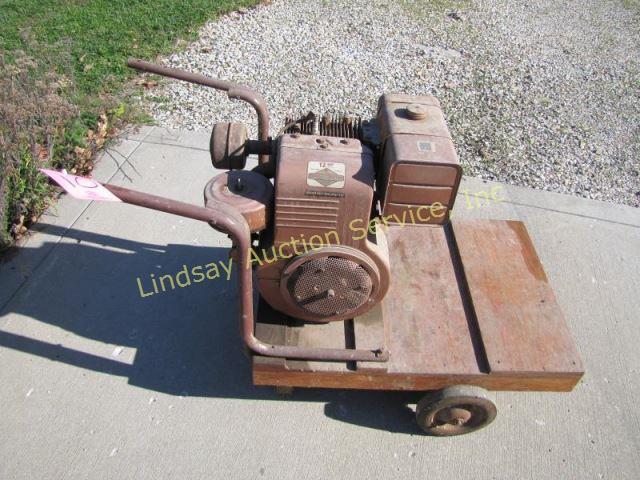

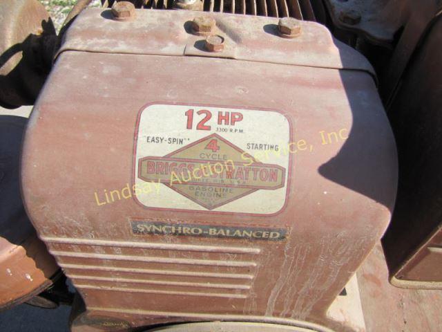

jellyghost 378 #1 Posted November 16, 2016 Because my wheel horse has been so much fun, I have been trying to learn more about engines and tractors. There was an auction in my area, and it appears that I just won this Briggs and Stratton engine for $27.50. What can you tell me about it? Do I need to buy a starter? Junk or jewel? 2 Share this post Link to post Share on other sites
857 horse 2,588 #2 Posted November 16, 2016 (edited) Jelly,,,,,,,,,,,,looks like a rope pull to start it,,,,,I would drain the gas tank....clean it if it is gummed or varnished up....(( I use acitone )) about a cup swish it around with some nuts and bolts...15-20 minutes,,,,drain it all out,,,dry it......until its clean....remount it....add in a new plug,,,,,and some gas,,,,set the choke and HIT IT !!!!!!.....if it don't hit,,,,spray a little carb cleaner in the carb....should fire off.......if it dont stay running.....the carb may have to come off and be cleaned.....12 Horse.....thats got some power.!!!!!! Edited November 16, 2016 by 857 horse 2 Share this post Link to post Share on other sites
Achto 32,964 #3 Posted November 16, 2016 42 minutes ago, jellyghost said: Because my wheel horse has been so much fun, I have been trying to learn more about engines and tractors. There was an auction in my area, and it appears that I just won this Briggs and Stratton engine for $27.50. What can you tell me about it? Do I need to buy a starter? That looks like a nice vintage Briggs. I agree with Howard that it is a rope start engine. Adding an electric start does not look like an option, unless you want to change the fly wheel add a stater and change the fan cowling. I would definitely change the oil, clean the fuel system and see if it will run. Good luck and have fun! 2 Share this post Link to post Share on other sites
jellyghost 378 #4 Posted November 16, 2016 Thank you for all of this advice! Do you guys think it came out of a garden tractor? Do you think the owner was using it for something mounted on this cart? Share this post Link to post Share on other sites

KC9KAS 4,746 #7 Posted November 16, 2016 7 hours ago, achto said: That looks like a nice vintage Briggs. I agree with Howard that it is a rope start engine. Adding an electric start does not look like an option, unless you want to change the fly wheel add a stater and change the fan cowling. I would definitely change the oil, clean the fuel system and see if it will run. Good luck and have fun! It would use a starter generator with a belt to the flywheel where the pull-rope would wrap. We have a B&S 14 hp that is made the same. The fuel tank is hiding the S/G bracket bolt holes. The tank would have to be relocated. 4 Share this post Link to post Share on other sites
Ken B 3,203 #8 Posted November 16, 2016 You did real well on that Briggs, looks to be in real nice shape. Perfect engine for a tractor or a log splitter... Share this post Link to post Share on other sites
Achto 32,964 #9 Posted November 16, 2016 2 hours ago, KC9KAS said: It would use a starter generator with a belt to the flywheel where the pull-rope would wrap. We have a B&S 14 hp that is made the same. The fuel tank is hiding the S/G bracket bolt holes. The tank would have to be relocated. Good call! I forgot about the starter/gen option. Which is strange because I don't have very many engines with a Bendix style starter. 10 hours ago, jellyghost said: Thank you for all of this advice! Do you guys think it came out of a garden tractor? Do you think the owner was using it for something mounted on this cart? Not sure what the PO might have used it for. You could put it on a tractor if you find a good candidate. I would get it running good first then find it a job to do. 1 Share this post Link to post Share on other sites
lynnmor 9,081 #10 Posted November 16, 2016 I believe that B&S used that gold colored paint on replacement engines. It may not have come off anything, but instead was purchased for a project never completed. Has anyone ever seen the gold color on equipment as purchased? 1 Share this post Link to post Share on other sites
Molon_Labe 731 #11 Posted November 16, 2016 That appears to be a cast iron, ball bearing engine, one of the really good ones! If you have never taken one of those Flo Jet carburetors apart before there is more to it than taking the 4 screws out of the bowl, Here is a good link that shows the disassembly process. http://outdoorpowerinfo.com/repairs/briggs_large_two-piece_flo-jet.asp 3 Share this post Link to post Share on other sites
Don1977 606 #12 Posted November 16, 2016 34 minutes ago, lynnmor said: I believe that B&S used that gold colored paint on replacement engines. It may not have come off anything, but instead was purchased for a project never completed. Has anyone ever seen the gold color on equipment as purchased? Briggs used that color for engines sold to the public for quite a few years. Share this post Link to post Share on other sites
DougC 2,644 #13 Posted November 16, 2016 I was going to guess you bought a T bone steak with your $27.50. You will have more fun with the 12 horse I bet! Share this post Link to post Share on other sites

Elkskin's mower junkyard 1,117 #15 Posted November 17, 2016 my sears suburbans have cast iron briggs they are power houses. alot of torque. downside is the gas usage. that pulley on flywheel side is a s/g pulley. but can use a rope lol 1 Share this post Link to post Share on other sites

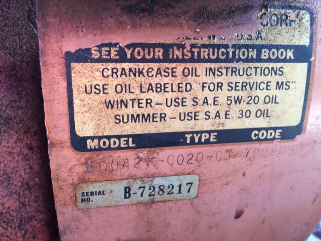

jellyghost 378 #16 Posted November 17, 2016 14 hours ago, lynnmor said: I believe that B&S used that gold colored paint on replacement engines. It may not have come off anything, but instead was purchased for a project never completed. Has anyone ever seen the gold color on equipment as purchased? It's an interesting color. It is kind of a dust rose, but it has a little shine to it. I picked it up today, and it was much heavier than I thought it would be! I was able to load it, and while unloading it, my neighbor came over. He had two similar old engines that were directly linked to generators. That would be an interesting use, but I just hope to get it running first. The seller included a photocopy of an "Illustrated Parts List" for models: 80200 to 80299 and 81200 to 81299. But... the picture below shows model number: 800421. There is a hand written note about a model 80202 from the previous owner. The parts list looks similar to this engine but smaller, and it isn't quite right. Share this post Link to post Share on other sites
Elkskin's mower junkyard 1,117 #17 Posted November 17, 2016 first digit is a 3 thats a 30 cubic inch bore Share this post Link to post Share on other sites
jellyghost 378 #18 Posted November 17, 2016 (edited) I just found a resource that explains the model number, type, and code. This engine was made in 2/9/1970. https://www.briggsandstratton.com/content/dam/briggsandstratton/na/en_us/Files/Numerical_Designation_System.pdf 16 minutes ago, craftsmanmowerfreak said: first digit is a 3 thats a 30 cubic inch bore Oh! That makes more sense, and that allowed me to find the correct parts diagram. Edited November 17, 2016 by jellyghost Share this post Link to post Share on other sites
