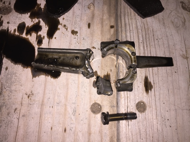

ClassicTractorProfessor 5,455 #1 Posted November 15, 2016 As some of you may remember I threw a rod through the block of my 1277 while mowing this summer. I acquired a block from a fellow member here and was gonna use it to build a new engine, but have decided to hold on to it to use for a custom project I see later on down the road don't let the suspense of that kill y'all lol. Anyway I scored a heck of a deal on a running K241 the other day, problem is the output shaft is not only a bigger diameter but also shorter than needed for my pto. I know the stroke is different on the 241 from the 301, but is this due to the crank or a difference in rod length? My K301 crank miraculously survived the carnage that day, was curious if it could be swapped into the K241 I picked up the other day, and if so, what combination of parts do I need? Thanks in advance Share this post Link to post Share on other sites

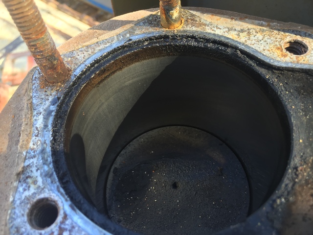

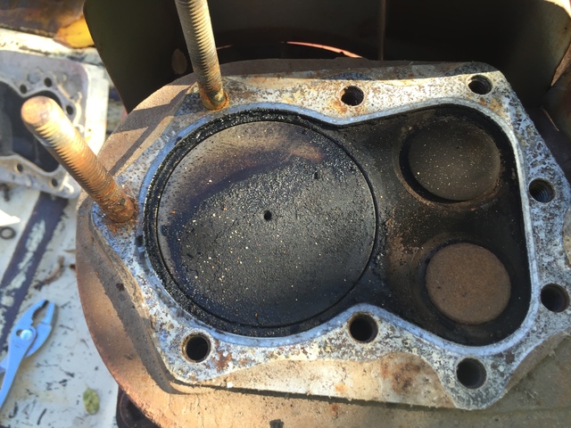

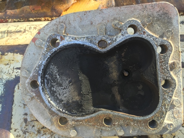

ClassicTractorProfessor 5,455 #12 Posted November 16, 2016 pulled the head off the 241 I have here just now...looked pretty clean inside...hopefully won't have to do too much machine work to get this old girl up and running again 1 Share this post Link to post Share on other sites
953 nut 69,478 #13 Posted November 17, 2016 A down and dirty method of checking the cylinder is to remove your compression ring and insert it at the top of the cylinder. Measure the end gap and see if any light is visible at the sides to indicate out of round; push the ring down the cylinder an inch using the piston to keep it square; recheck then go down another inch and so on.If the end gap is consistent and no gaps are evident around the ring the cylinder is good to go. 2 Share this post Link to post Share on other sites
ClassicTractorProfessor 5,455 #14 Posted November 17, 2016 24 minutes ago, 953 nut said: A down and dirty method of checking the cylinder is to remove your compression ring and insert it at the top of the cylinder. Measure the end gap and see if any light is visible at the sides to indicate out of round; push the ring down the cylinder an inch using the piston to keep it square; recheck then go down another inch and so on.If the end gap is consistent and no gaps are evident around the ring the cylinder is good to go. Thanks for the tip...I plan on disassembling this engine soon as I can come up with a place to do it...wife shot down my idea of building an engine in the back bedroom that we use for storage so have to find somewhere else to do it sometimes I think they just don't understand 1 Share this post Link to post Share on other sites
