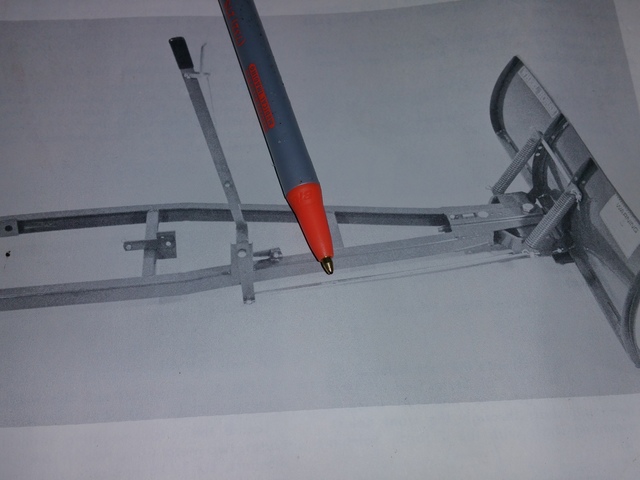

JERSEYHAWG / Glenn 4,589 #1 Posted November 15, 2016 ok, on one of my plow blades the PO must have damaged the blade control rod. He rigged up a coat hanger to do the job, I guess it worked. But talk about flimsy, I cant believe that wire never broke. The picture has the pen pointing to the blade control rod. Its a stout piece. Where can I get one? What have you guys used in its place to replace it? Any and all ideas considered, in my time here you fellas have come up with great ideas on things. Thanks, Glenn Share this post Link to post Share on other sites
Lane Ranger 12,094 #2 Posted November 15, 2016 Glenn: I have one that I would send you for the cost of mailing it to you. I will have to find out what it costs to send in a tube It is about 34 inches long. Send me your address and I can send you my email for paypal and we can work it out. It is all painted up ! I bought a bunch of snowplow parts from antoerh member becasue I am always buying snoplows I don't need to resell! Lane 7 Share this post Link to post Share on other sites
Ed Kennell 47,026 #3 Posted November 15, 2016 Man, I can't believe a coat hanger would not bend when you are trying to push that blade to angle left. ACE hardware has 36" lengths of 3/8" round stock. 3 Share this post Link to post Share on other sites

lynnmor 9,013 #6 Posted November 15, 2016 Maybe he ran the 3/8" rod up to the handle? 3 Share this post Link to post Share on other sites
Racinbob 13,112 #7 Posted November 15, 2016 My rod is actually 1/2" but 3/8" would work. You could get a piece of rod, thread the ends and get a couple of threaded trunnions. 2 Share this post Link to post Share on other sites

Walt 339 #10 Posted November 15, 2016 It may work if blade is off ground but if blade was down I believe friction from weight of blade on ground would be more than coat hanger could over come. 2 Share this post Link to post Share on other sites
JERSEYHAWG / Glenn 4,589 #11 Posted November 15, 2016 4 minutes ago, Walt said: It may work if blade is off ground but if blade was down I believe friction from weight of blade on ground would be more than coat hanger could over come. I have to agree, it's so flimsy looking, a couple coat hangers twisted together. I never used it, when I picked it up, threw it in the shed, and that's where it's been for a couple years. My gawd, just moving the smaller blade around, just loose , by itself, is heavy as can be. Thats the 42 inch for the C-175. I never used a blade yet, just the snowblowers. Let's just suffice to say it's nonsense. I was messing with the smaller blade for mounting on the C-175. And agree with all the comments made. There is no way it could have worked. No way. Glenn 1 hour ago, DougC said: Looking forward to the pictures. I bet somebody will start a thread called HOW TO MAKE THINGS OUT OF COAT HANGERS. Let me know when you see they can make hair out of them. My salvation, then I can get rid of some ball caps. Glenn 2 Share this post Link to post Share on other sites
