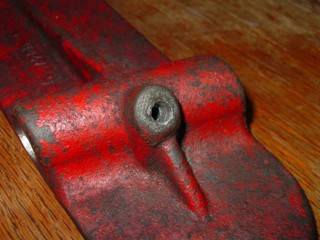

eibbed 63 #1 Posted November 14, 2016 (edited) Gentlemen, The bolt was broken off flush with the foot rest. I drilled out the center with a left handed drill bit and have tried unsuccessfully to unscrew the rest of the bolt. Do I go to a larger bit and drill out the rest of the bolt, then tap the hole? Thanks in advance, Dave Edited November 14, 2016 by eibbed trying to attach photo Share this post Link to post Share on other sites

lynnmor 8,738 #20 Posted November 27, 2016 The hole looks bad, I think that boring and tapping it for a Heli-Coil might give a better result. Share this post Link to post Share on other sites

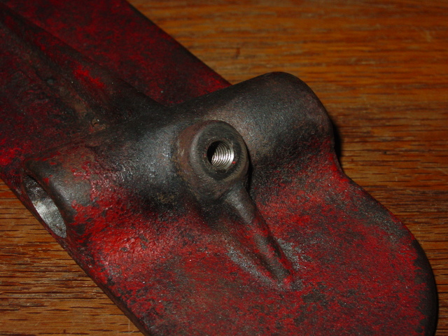

eibbed 63 #24 Posted December 10, 2016 (edited) Hi Mark, Yes it did. It arrived in the mail today and it looks absolutely great! I have always liked this style foot rest, so it is going on my 702. To me, it will always be a warm reminder of your generosity. And thanks to all of my fellow Red Square Members who have helpfully commented on this project. I hope you don't mind, but I took a picture to show off your good work. Thanks again, Dave Edited December 10, 2016 by eibbed 4 Share this post Link to post Share on other sites
