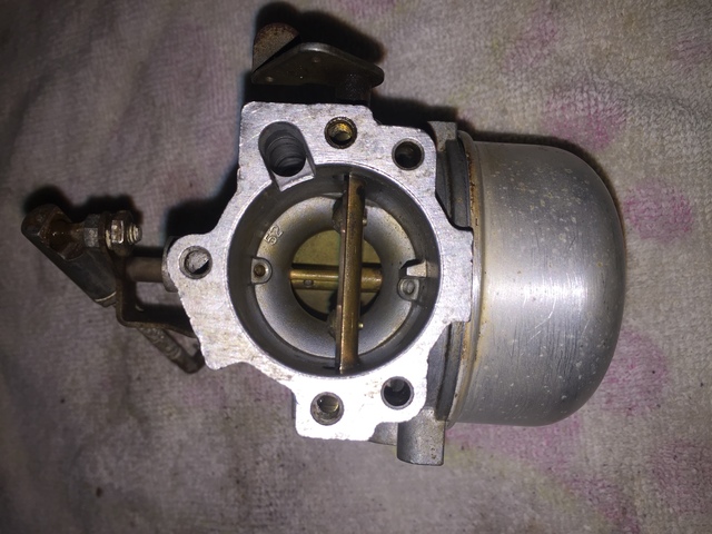

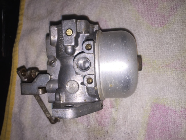

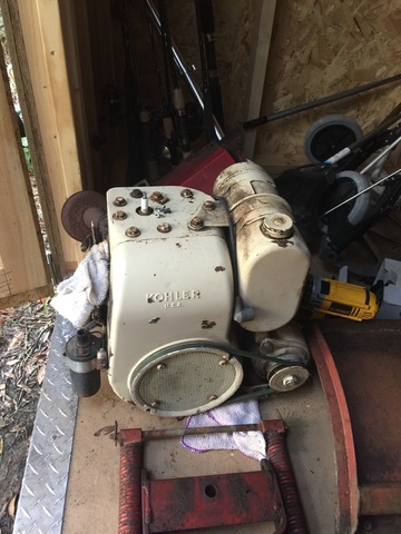

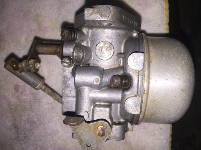

FrKsHwZ 15 #1 Posted November 13, 2016 Today while I was cleaning out my shed, I stumbled on my carb I been trying to locate for awhile. I do remember that I bought a rebuilt kit and it was wrong (2x) through EBAY. Then I guess I got frustrated and misplaced it. So I'm asking for reputable rebuilt kits that won't cost a lot. Share this post Link to post Share on other sites
gwest_ca-(File Mod) 12,277 #2 Posted November 13, 2016 Looks like your carb part number is 47-053-08. Shows up for the K241 and K301 plus M10 and M12 on page 1.3 That should give you original kit numbers. Garry 2 Share this post Link to post Share on other sites

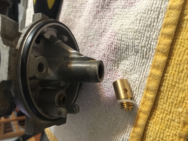

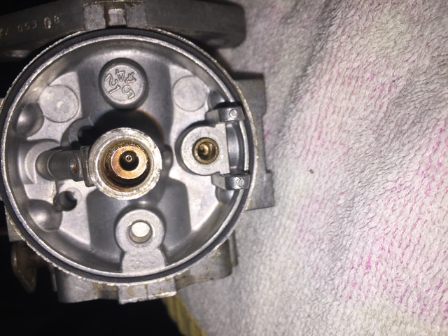

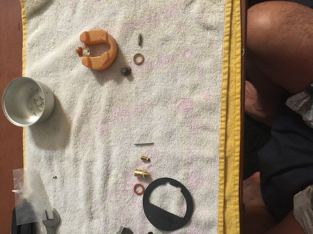

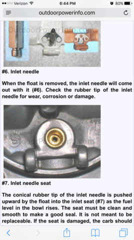

FrKsHwZ 15 #4 Posted November 13, 2016 Well hopefully I didn't get the wrong rebuilt kit again. I was luck or maybe unlucky that a local shop had some K series parts, I ask for a 25-757-02 rebuilt kit for my k241. Well I was told it was replaced with 25-757-01 kit, I had the reference from the above link and showed him. Then was told it hasn't been updated. So again I get home, and the float pin and gaskets fit only. I must be doing something wrong but in the last picture, this part fits nowhere on my carb. Help please. Share this post Link to post Share on other sites
FrKsHwZ 15 #5 Posted November 13, 2016 So I guess is did get the wrong one, but at least my gaskets fit that's what I needed after all. The carb ran fine before, we will see. Thanks again...! 1 Share this post Link to post Share on other sites
