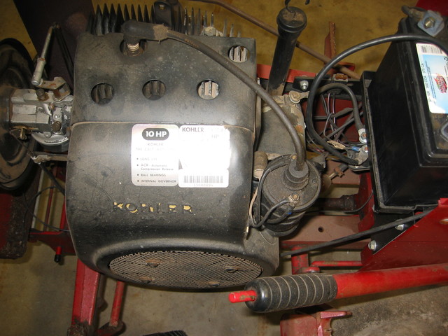

pfrederi 21,314 #12 Posted November 12, 2016 Does this look like your set up?? Knowing your spec number would help... Share this post Link to post Share on other sites
gwest_ca-(File Mod) 12,536 #13 Posted November 12, 2016 His spec number is 46863 which is correct for 1986. Garry 2 Share this post Link to post Share on other sites

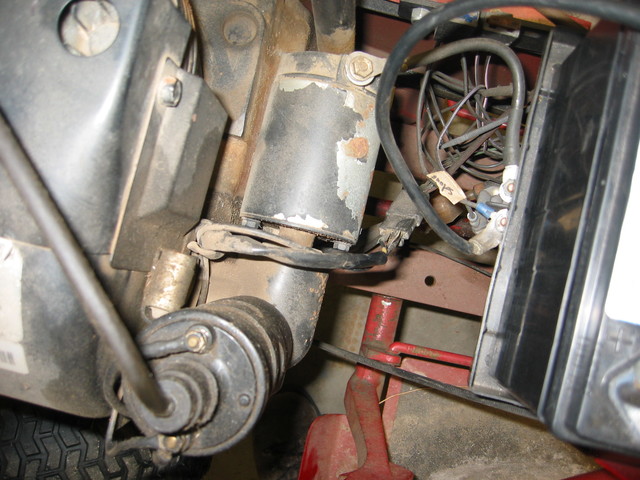

pfrederi 21,314 #14 Posted November 12, 2016 (edited) 21 minutes ago, gwest_ca said: I am having ISP connection issues. I have the 3 amp system 46849 46489 spec. There are three wires on the engine side of the plug. One is coil, yellow is headlight and black is charge circuit. I can feel i think the diode just inside the plastic sleeve. Mine shows less then one ohm to ground on the light circuit...open on the charge circuit. On teh WH side of the plug there are two wires connected to the charge terminal. i have to trace those to see why the split. Edited November 12, 2016 by pfrederi Share this post Link to post Share on other sites
grine_22 145 #15 Posted November 12, 2016 Yes that looks like my setup Share this post Link to post Share on other sites
pfrederi 21,314 #16 Posted November 12, 2016 I am wondering if you fried the diode...Did you check for resistance with the probe between the diode and the stator??? In mine the diode is just inside the plastic sleeve. One confusion here the WH wire diagram colors are only applicable from that side of the plug on through the tractor. Kohler used different colors...yellow for the head light blackish for the charge circuit. Share this post Link to post Share on other sites
