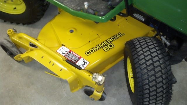

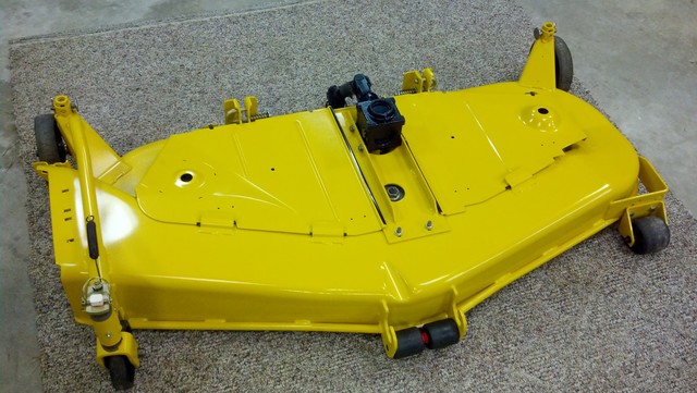

RedRanger 1,470 #11 Posted November 11, 2016 (edited) I had my worker deck blasted and powder coated 2 seasons ago and it still looks new. No chipping. No peeling. No scratching, even from scraping the underside of the deck a couple times now. My powder coater also added teflon to the powder coat which helps with the grass sticking. I personally disagree with all of you. If prepped right, Can't beat powder coat. Everything else wears off. He says he's been powder coating decks for lawn care companies for the past 3+ years and they keep bringing their new equipment in. They love it. Edited November 11, 2016 by RedRanger 1 Share this post Link to post Share on other sites

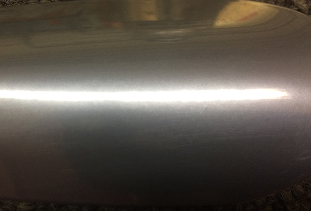

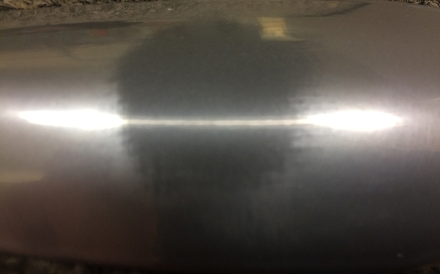

WheelHorseNut 222 #12 Posted November 11, 2016 @RedRanger I'm with you -- we have two powder coaters that we work with and it's an extremely durable coating method. Very chip resistant. It all depends on the type of coating you use. I have chip books from several different suppliers and, just like paint, they have different grades of coatings. A transparent coating will scratch and chip easily while some of the matte finishes are very chip resistant and chemical resistant. I have done a test on a few different finishes with acetone. I have a matte black with a slight texture (I'm going to have them do my seat pan) that is not affected by acetone at all while I have a silver color that wipes right off with acetone. It all depends on the finish. The opaque yellow that you have on that deck looks great. One of the coating companies we work with does the frames for a very well known kit car company -- they come out great. You should see the line they go on -- very impressive! It is a durable coating but there are variables involved. 1 Share this post Link to post Share on other sites

WheelHorseNut 222 #15 Posted November 12, 2016 18 hours ago, DennisThornton said: I've used similar "neutralizer"s but lost track of their long term performance. Thanks for sharing! I'm not qualified to bad mouth powder coat across the board. I'm just not impressed with what I've seen. I'm very surprised that some can be removed with acetone though! Yeah, it's no substitute for a paint like finish -- you can't get it nearly as shiny (mirror like) as paint. The closest I've seen to that is a polished finish (like a plated finish or a polished aluminum or stainless) with a translucent over it. It gives you that reflective quality of paint. The only thing is, you can't match the color of a solid with that process. So, while it looks awesome, it's not going to look like a solid paint or powder coat (colors are lighter, etc.). I have some powder coated pieces at work that I'll snap some pics to show what I'm talking about. I have some really good quality gloss black pieces that look great! I'll snap a pic, of a powder coat that I can remove with acetone, on Monday. It's very scratch and chip resistant, just not good with chemicals. It's too bad, too, because it's a really nice color! 3 hours ago, Sarge said: The galvanizing I'm leaning towards is the same bright appearance type used for guard rails , marine equipment and other industrial applications . It is not the extreme heat hot dip type as that would likely warp the snot out of a mower deck . If I had the cash , I'd rebuild my old Land Cruiser and have the whole thing dipped - it's already fairly common to see restorations with zinc dipped frames to prevent future rust issues . The stuff is self-healing and will not allow rust to form underneath , unlike any type of paint or powder coatings . https://www.azz.com/ Sarge What does that process run, price-wise, Sarge? Share this post Link to post Share on other sites
DennisThornton 4,773 #16 Posted November 12, 2016 On 11/11/2016 at 10:28 AM, RedRanger said: I had my worker deck blasted and powder coated 2 seasons ago and it still looks new. No chipping. No peeling. No scratching, even from scraping the underside of the deck a couple times now. My powder coater also added teflon to the powder coat which helps with the grass sticking. I personally disagree with all of you. If prepped right, Can't beat powder coat. Everything else wears off. He says he's been powder coating decks for lawn care companies for the past 3+ years and they keep bringing their new equipment in. They love it. That what's so great about this forum. My experience with powder coat has left me wanting, but your experience proves that it can be done well. Might I ask what it cost you to refurb that fine looking deck? The sandblasting and coating but separately priced perhaps? And what prep was done after the sandblasting? Share this post Link to post Share on other sites

RedRanger 1,470 #18 Posted November 13, 2016 16 hours ago, DennisThornton said: That what's so great about this forum. My experience with powder coat has left me wanting, but your experience proves that it can be done well. Might I ask what it cost you to refurb that fine looking deck? The sandblasting and coating but separately priced perhaps? And what prep was done after the sandblasting? I paid about $300 total but it's a 60" deck with a $1000 value. All blasting and prep was included. I do know the guy doing the powder coating said that just like paint, there are many qualities of powder and prep work means a lot. I believe he blasts and then bakes off any oil residue in his oven, then cleans it again and then powder coats and bakes again. 2 Share this post Link to post Share on other sites
WheelHorseNut 222 #19 Posted November 14, 2016 On 11/13/2016 at 10:38 AM, RedRanger said: I paid about $300 total but it's a 60" deck with a $1000 value. All blasting and prep was included. I do know the guy doing the powder coating said that just like paint, there are many qualities of powder and prep work means a lot. I believe he blasts and then bakes off any oil residue in his oven, then cleans it again and then powder coats and bakes again. @RedRanger Yup -- that's basically how they do it. Gotta get the oil and contaminants off. @DennisThornton Dennis -- here are the pics of the powder coating I can remove with acetone. It's a specialty coating, so I'm not totally shocked that it comes off. I'm doing my seat pan in the very near future and I'll post pics on my restoration thread (Raider 10). I'm doing a slightly textured matte black to match the original. Before After 1 Share this post Link to post Share on other sites
