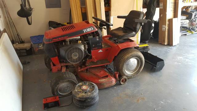

George Washington 68 #1 Posted November 8, 2016 (edited) Ok, im new to Wheel Horses and I'm in love - I picked up a D-200 a few months ago for super cheap ($150) and sold it a week later when someone offered me a pile of cash. I regret selling it but after some research I found a 520h for sale (pic attached). It has 800 hours, looks like it has been taken care of, and comes with a box blade and wheel weights and a 42 inch deck. I'm told that it overheats a bit after 30 minutes but I'm thinking there is a fix for that. My questions are what all attachments will this thing take and is it really the beast that I've heard that it is? I know its not a D-200 but I want to be able to hook up about anything and be able to work. I wouldn't be working it daily - mostly just weekend stuff on my 8 acres. A little bit of everything, plowing, discing, tilling, grading, and mowing - thanks in advance for the advice! Edited November 8, 2016 by George Washington 8 Share this post Link to post Share on other sites
Digger 66 3,530 #2 Posted November 8, 2016 (edited) Welcome to Redsquare . Looks like you even got the matching battery charger Edited November 8, 2016 by Digger 66 Share this post Link to post Share on other sites

lynnmor 9,073 #4 Posted November 8, 2016 The first thing that I would address is the over heating. If the engine is the problem, pull the tin off and clean the fins completely. These engines will have a valve seat failure if run hot. If the transmission runs hot, check for a damaged, loose or missing fan. Clean those fins as well. It is a good idea to do this service regardless. 2 Share this post Link to post Share on other sites
smoreau 658 #5 Posted November 8, 2016 (edited) Most attachments will fit the 520. Dozer blade will require a extension. Other then that any attachment should fit, but may need a different belt. Power is great and the trans is strong. Regular maintenance with this tractor is a must! Onen engines are thirsty! But if its not mantained it will cost you 10 more times the maintenance cost. Edited November 8, 2016 by smoreau Share this post Link to post Share on other sites
oldlineman 1,820 #6 Posted November 8, 2016 Welcome to the square nice tractor not an expert on 520's but I believe that is a 48" deck if cut adjustment is on the left 48", on the right 42". Have fun 1 Share this post Link to post Share on other sites

Tankman 3,528 #13 Posted November 9, 2016 Nice Horse! Yes, 48" SD deck, height adjustment on the right. Be sure to clean all the engine and trans fan. Post your progress, we Horses' need updates! 2 Share this post Link to post Share on other sites

DennisThornton 4,773 #17 Posted November 9, 2016 One of the more desirable WHs. I really don't need it but I DO desire it. Most all C, 300,400 and 500 series attachments will fit, though as already noted the dozer blade will need extension. This is because it has a forward swept axle that will also accommodate the 60" deck. I'm guessing you'll have to spend some time pulling the engine tin off and blowing out fins. My 2 cents from mowing with my 416 Onan is that there are better engine choices for mowing. Mine is however a great leaf and grass cutting collector! Seems they all try to gather on the engine shroud! Won't help with engine cooling! And if I might interject a question, guys, does the swept axle also mean steering gear reduction? Either way I'm pretty sure I'd have to buy it! Hubcaps, weights and if that was a 48" deck? Yep! Silly match up IMHO to put a 42" on that 20 hp beast! 2 Share this post Link to post Share on other sites

Kurt-NEPA 756 #19 Posted November 10, 2016 Welcome to Red Square - Looks like you found a great deal on a nice 520H. I agree with some others. If it overheating, I would you pull the engine shrouds and clean the cylinders and heads. Most likely it packed with oil, dirt, and grass. Especially the rear cylinder. Even if it wasn't overheating, I would suggest you do that. Lots of help here if you decide to get it. Kurt 2 Share this post Link to post Share on other sites

DougC 2,644 #21 Posted November 10, 2016 Is it the Eng. temp. light or the Hydro Temp. light on the dash that comes on after 30 min.? Or why does the seller think it is over heating? What are the symptoms? Does it smoke when starting up, increasing the throttle or under load? 500 dollars is a lot of money to buy a tractor that will cost you 1,500 dollars to repair if the Onan has a valve seat problem.... Beware of sellers selling a tractor with a problem...... They are quite often not telling you the entire truth.... It has been my experience.... 1 Share this post Link to post Share on other sites
