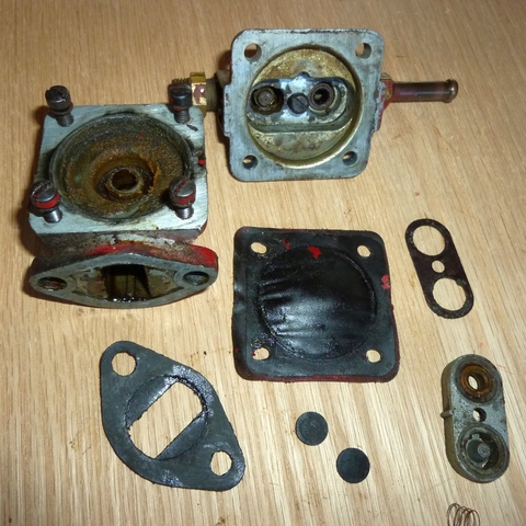

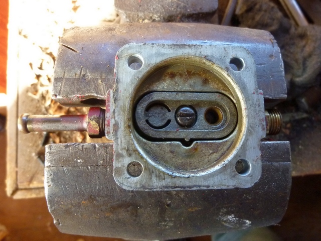

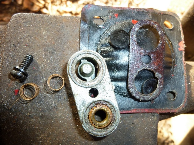

CTPhil 53 #26 Posted November 18, 2016 I took it apart and have the parts soaking in acetone. It looks like I should be able to just clean it up. Wish I had a piece of whatever that gasket/diaphram is made out of though. The carb body is in the carb soak can. 2 Share this post Link to post Share on other sites
wallfish 20,738 #27 Posted November 19, 2016 3 hours ago, CTPhil said: Wish I had a piece of whatever that gasket/diaphram is made out of though. Try contacting @buckrancher (Brian) for a diaphragm. Think he makes them. Share this post Link to post Share on other sites
wallfish 20,738 #29 Posted November 19, 2016 Let me know if Brian can't hook you up. I have some diaphragm material but it might be thinner, not sure what those pumps use. Could be the same too. It's used for Ohlsson & Rice carbs. Share this post Link to post Share on other sites
CTPhil 53 #30 Posted December 4, 2016 Finally something to report. I rebuilt the carb, put the fuel pump back on with a new diaphram from Brian. And...it runs! I'm not sure about the engine health however, I'm pretty sure it at least needs a new head gasket. https://youtu.be/ViAgPnDwsQM Share this post Link to post Share on other sites

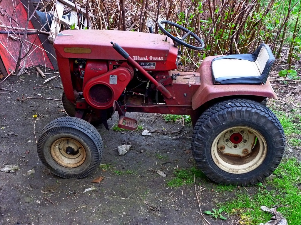

CTPhil 53 #31 Posted April 28, 2017 The 875 spent the Winter in the stock trailer. It did need a head gasket. So yesterday I fired it up and drove it off the trailer. It's going to need some tinkering and a serious clean up of course, but it runs and drives. I'm planning to take it to the CAMA tractor show in Kent, CT May 6-7. Share this post Link to post Share on other sites
