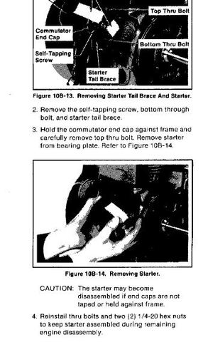

pfrederi 21,172 #3 Posted November 8, 2016 Your 1987 30 should have a Magnum engine. If so be careful with the starter motor. When you unbolt it from the engine the end caps can fall off and innards spring out. have you checked all connections for hidden corrosion??? 1 Share this post Link to post Share on other sites

Tonyp 285 #6 Posted November 8, 2016 Good stuff gents ! Yes, the motor is spinning/turning , thats what I mean by moaning, yes I have cleaned the connections but I will a gain. This has been happening intermittently for several months now so I knew it was coming. Now and then the starter doesn't even spin so I suspect starter and solenoid , but we'll see... yes an M10 Magnum 10. I am going to pull the starter, carefully and check it out, maybe it is just the spring, thx to all ! Share this post Link to post Share on other sites
Tonyp 285 #7 Posted December 9, 2016 Good news, Starter was non operational but not bad, just needed TLC, meaning cleaning of the brushes, armature and the Bendix. It's all back together and working like a charm ! Thx to all above for the excellent information and details. I did have questions about re-assemble.. see that here 1 Share this post Link to post Share on other sites
