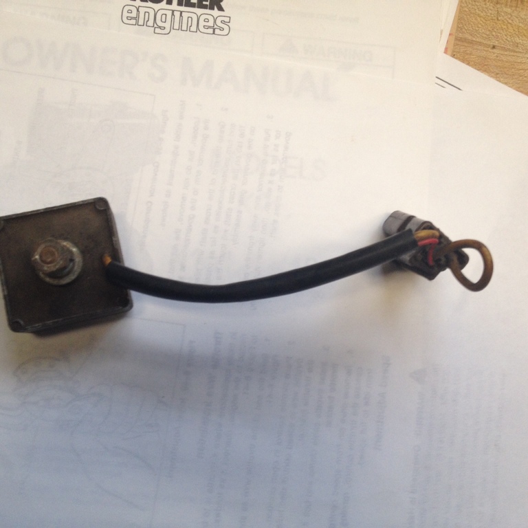

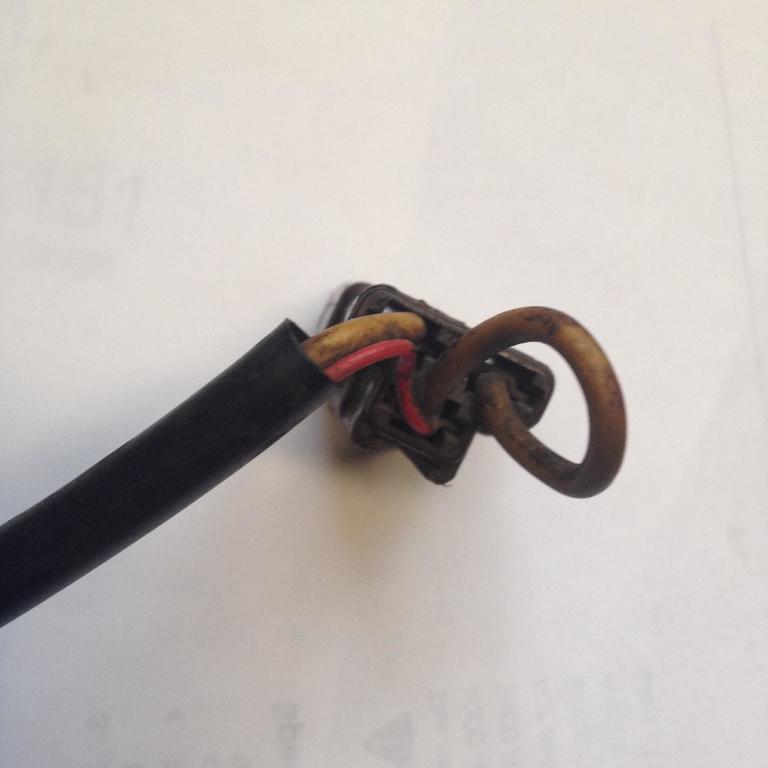

JackHorse 11 #12 Posted January 16, 2017 If I may add a question to this thread... My 1982 C85 runs great (knock on wood) with no electrical problems but I want to rewire this winter due to a lot of fairly corroded connections I'm seeing. As I'm disassembling things I noted the rectifier red wire is jumped to one of the stator wires at the plug connector...like I said, it's been running fine like this, I'm just curious if this is correct because the wiring diagram is not exactly clear on that. Also how does that work given the stator puts out AC voltage? Thanks 1 Share this post Link to post Share on other sites
gwest_ca-(File Mod) 12,237 #13 Posted January 16, 2017 Don't know why it works but it does. Even the larger finned regulators with 3 terminals have one of the AC terminals connected internally to the DC+ output. I discovered this on one that had the correct AC terminal rusted right off. Just tied that stator wire to the DC+ and has worked for years. I believe SOI explained why it works but can't find it. Garry 2 Share this post Link to post Share on other sites
oldredrider 2,553 #14 Posted January 16, 2017 Garry is correct about the internal wiring connection in the R/R. What you have is an "external" connection to compensate for a partially incapacitated regulator. "Red neck engineering" that works. 1 Share this post Link to post Share on other sites
JackHorse 11 #15 Posted January 19, 2017 Thanks for the responses guys, I guess it's one of those things you just have to accept without know why..It does work after all.. Share this post Link to post Share on other sites
953 nut 66,109 #16 Posted January 20, 2017 On 1/16/2017 at 0:28 PM, gwest_ca said: I believe SOI explained why it works but can't find it. If I recall correctly it was a method of getting one rectifier to do the work of two. I think SOI said the jumper would pass half a cycle and the other half would go through the rectifier. Some of what SOI tells us I completely understand, others I just have to take on faith. 1 Share this post Link to post Share on other sites
