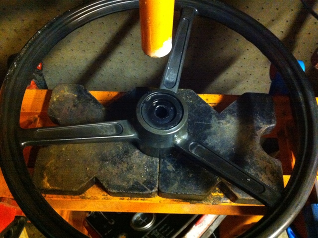

ACman 7,700 #7 Posted November 6, 2016 Don't forget the trick (can't remember who) drilling between the shaft and hub so your penetrating oil can soak all the way through . A little heat don't hurt either . @wallfish's idea sounds the easiest though ! @squonk I like the way you think...go big or go home...or just grab a bigger hammer ! It's definitely a good way to let out your frustrations ! 2 Share this post Link to post Share on other sites
Wishin4a416 2,473 #8 Posted November 6, 2016 I have done 3 with the 20 ton press. You have to take the upper dash off too. I never had one come right off. 1 Share this post Link to post Share on other sites

GT14 243 #15 Posted November 7, 2016 Drilled down to the shaft applied liquid wrench then the 12t press. Share this post Link to post Share on other sites
