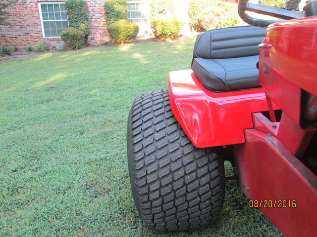

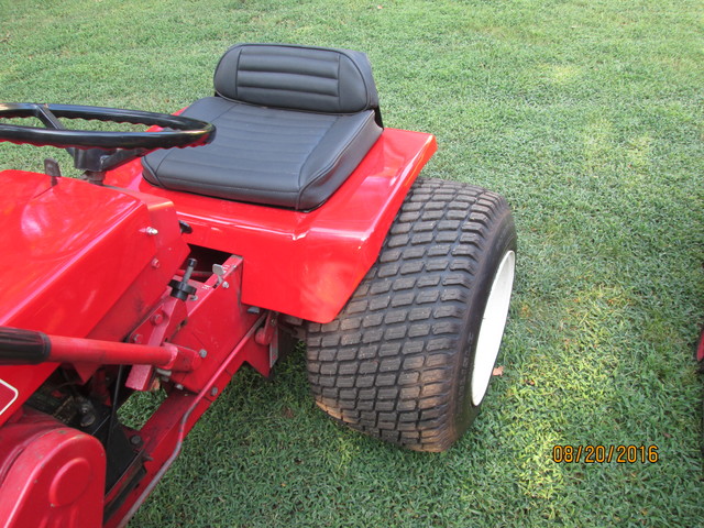

Gunman64 7 #1 Posted November 4, 2016 What's the biggest tire that I can use in the rear of a 310-8? Would 23X10.50X12 work? Thanks Share this post Link to post Share on other sites
953 nut 63,570 #2 Posted November 4, 2016 32 minutes ago, Gunman64 said: Would 23X10.50X12 work That is what I have on the rear of my 312-8 (virtually the same tractor). 1 Share this post Link to post Share on other sites
Gunman64 7 #3 Posted November 4, 2016 5 hours ago, 953 nut said: That is what I have on the rear of my 312-8 (virtually the same tractor). How do they fit, are they real close to the fender? Share this post Link to post Share on other sites
Sparky-(Admin) 24,252 #4 Posted November 4, 2016 If you mount the 10.5 tire on the standard width rim (7" or 7.5") it will be a bit taller than 10.5....might be close to the fender. The WH factory only mounted 10.5 rubber on the wider rims (8.5"), those rims came on the 520's and the GT-1800's (I think there was another model but I cant remember). Mike.......... 1 Share this post Link to post Share on other sites
wallfish 18,859 #5 Posted November 4, 2016 (edited) 46 minutes ago, Sparky said: (I think there was another model but I cant remember) 418-C had those too. Or, at least mine does Edited November 4, 2016 by wallfish 2 Share this post Link to post Share on other sites
Duramax7man7 506 #6 Posted November 4, 2016 1 hour ago, Sparky said: If you mount the 10.5 tire on the standard width rim (7" or 7.5") it will be a bit taller than 10.5....might be close to the fender. The WH factory only mounted 10.5 rubber on the wider rims (8.5"), those rims came on the 520's and the GT-1800's (I think there was another model but I cant remember). Mike.......... 23" is the height, 10.5" the width and 12" the rim... I was considering some 24" which would be about 1/2" from the seat pan. Share this post Link to post Share on other sites
953 nut 63,570 #7 Posted November 4, 2016 4 hours ago, Gunman64 said: How do they fit, are they real close to the fender? Mine came already mounted on the 8.5" rims so there is no ballooning due to narrow rims; I should have mentioned this. Share this post Link to post Share on other sites
Gunman64 7 #8 Posted November 6, 2016 I've found a guy wwth some 23x9.5-12 for a good price. Should those work with stock rims? Share this post Link to post Share on other sites
Sparky-(Admin) 24,252 #9 Posted November 6, 2016 3 minutes ago, Gunman64 said: I've found a guy wwth some 23x9.5-12 for a good price. Should those work with stock rims? Those are a better choice for your stock rims than the 10.5's. Mike.... 1 Share this post Link to post Share on other sites

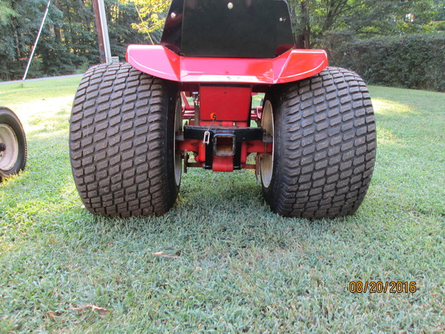

857 horse 2,588 #10 Posted November 6, 2016 these are 24x12.00x12...........on 12 wide rims......i know....wrong tractor......but i cant follow directions... 12 inches of rubber,,,,flat on the ground.. Howard857 Horse in Va 1 1 Share this post Link to post Share on other sites
Gunman64 7 #11 Posted November 6, 2016 3 hours ago, 857 horse said: these are 24x12.00x12...........on 12 wide rims......i know....wrong tractor......but i cant follow directions... 12 inches of rubber,,,,flat on the ground.. Howard857 Horse in Va Holy Moly, those look sweet! 1 Share this post Link to post Share on other sites
WheelHorseNut 222 #12 Posted November 6, 2016 @857 horse That looks awesome! It's like a pro street car from the rear! Love it! 1 1 Share this post Link to post Share on other sites
