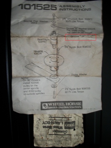

Keith of kent 47 #1 Posted November 3, 2016 Hi, I have a 73 C120 with a 5/0721 36" RD deck. This is fitted with the 103119 bearings. Should these bearings be fitted into the housing with the longer or the shorter part of the shaft to the top! if have a suspicion that I may have one fitted the wrong way around Thanks Keith Kent England Share this post Link to post Share on other sites
daveoman1966 3,884 #2 Posted November 3, 2016 This is it.... groove UP. Share this post Link to post Share on other sites
Keith of kent 47 #3 Posted November 3, 2016 Dave That was so quick! And so much useful info on that sheet that I didn't have like the torque settings Thank you Keith Share this post Link to post Share on other sites
