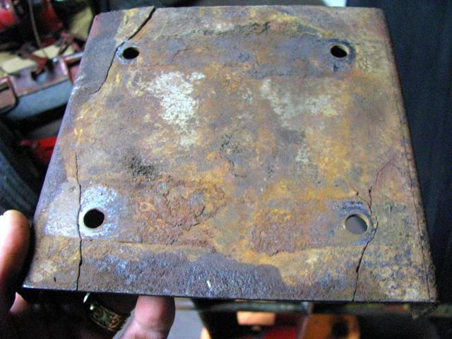

lynnmor 9,073 #12 Posted November 3, 2016 I have a weight box on the rear to counter the loader. Recently, the left rear transmission case developed a crack, and I think that the twist from weight far back is the reason. Share this post Link to post Share on other sites

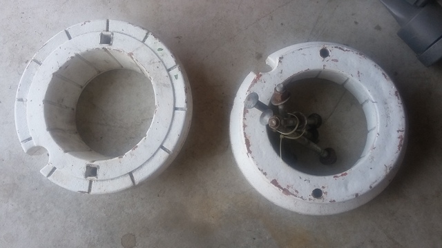

BOB ELLISON 2,983 #17 Posted November 4, 2016 I have read some posts about guys making wheel weights from lead . I was thinking on the same line but I just happened to pick some 35 or 40 pounders up at a action sale for $25.00. Plus the filled tires would give me about 75 or 80 pounds per tire. You could also make them from concrete. I just painted these red so they look more wheel horsey. 2 Share this post Link to post Share on other sites

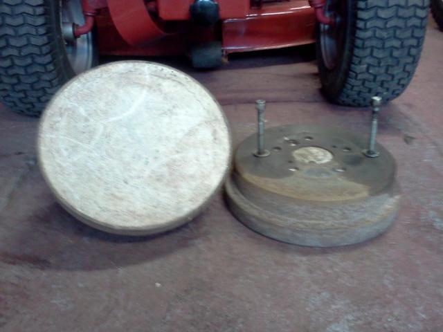

Tankman 3,528 #18 Posted November 5, 2016 Pick up a pair of scrap yard brake drums. I've done a few sets years ago. 1 Share this post Link to post Share on other sites

BOB ELLISON 2,983 #21 Posted November 5, 2016 1 hour ago, AMC RULES said: Just remember... Newton's third law. I have read some posts about guys making wheel weights from lead . I was thinking on the same line but I just happened to pick some 35 or 40 pounders up at a action sale for $25.00. Plus the filled tires would give me about 75 or 80 pounds per tire. You could also make them from concrete. I just painted these red so they look more wheel horsey. AMC Rules I had the same thing on both my C160's. I read it is a common problem. I made a 1/2 in plate and welded it on frame . There is a post here somewhere on how to make that plate, But I know you with all your posts already know the fix. On my 1995 520h it was added at the factory so wheel horse knew about it also. I think every one that uses a plow,tiller or blower needs to check that plate for cracks. All that weight we add will take it's toll someday. 1 Share this post Link to post Share on other sites
Jeff R. 35 #22 Posted November 5, 2016 AMC Rules/Bob, Were is this plate located on a C series tractor?? Thanks in advance. Jeff Share this post Link to post Share on other sites
AMC RULES 37,260 #23 Posted November 5, 2016 Where the trans mounts to the frame. 1 Share this post Link to post Share on other sites

DennisThornton 4,773 #25 Posted November 5, 2016 12 hours ago, Tankman said: Pick up a pair of scrap yard brake drums. I've done a few sets years ago. What did you use for a mold? Share this post Link to post Share on other sites
