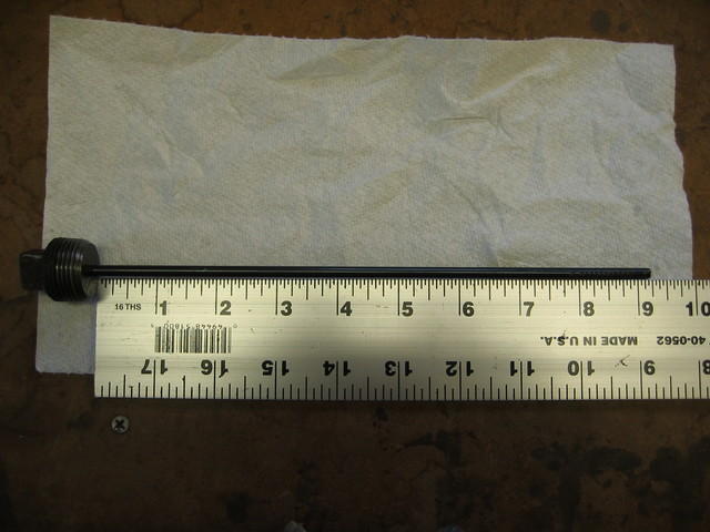

tommytunes 2 #1 Posted November 1, 2016 i have 1969 raider 12.there is no rod on dipstick plug. would like total length of rod and full and add measurements..thx Share this post Link to post Share on other sites
tommytunes 2 #2 Posted November 1, 2016 BTW its a K301 Share this post Link to post Share on other sites
gwest_ca-(File Mod) 12,146 #3 Posted November 1, 2016 If your model number is 1-6241 the engine oil capacity is 2-1/2 quarts. Some Raider 12's held 2 quarts but not in 1969. Garry 1 Share this post Link to post Share on other sites
pfrederi 20,249 #4 Posted November 1, 2016 From my 69 Charger 12 (It has the same spec# Kohler 47147C) 9 1/4" Long Full at 8" low at 8 7/8" 1 Share this post Link to post Share on other sites
tommytunes 2 #5 Posted November 1, 2016 perfect..thx Share this post Link to post Share on other sites
