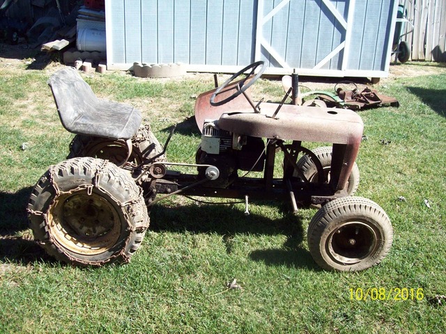

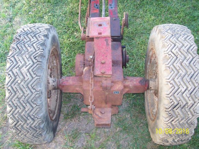

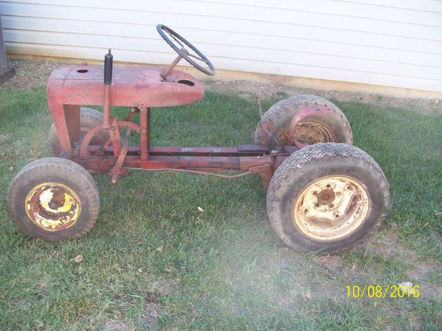

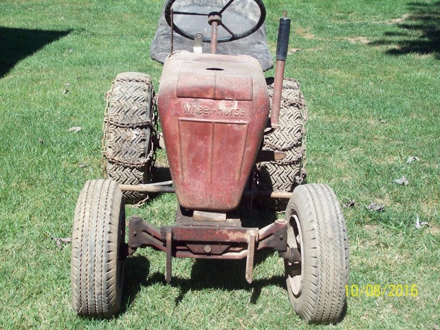

CLG253 26 #1 Posted November 1, 2016 Hi guys and girls. I am new here and new to the world of Wheelhorse. Love the site. Tons of information but I am still having some questions. I guess first I need to figure out what I have. I believe it to be a 60 or 61. It did not have original motor on it and I believe a different tranny. The frame was lengthened not sure if reason was motor or tranny or both. Here are some pics. Any and all help is appreciated. 6 Share this post Link to post Share on other sites
Upper Canada 213 #2 Posted November 1, 2016 (edited) Looks to be from 1961 as far as I know. And looks like a Frankenstein to me as well. I am sure someone with more knowledge will be along soon. Edited November 1, 2016 by Upper Canada 1 Share this post Link to post Share on other sites

AlwaysLookin80 1,308 #6 Posted November 1, 2016 Welcome, looks like a 61 suburban front frame and hood and a unidrive trans off of another early to mid sixties wheel horse. 3 Share this post Link to post Share on other sites
wallfish 20,733 #7 Posted November 1, 2016 (edited) 1961 model 401 with a later model's 4 speed trans attached as others have wrote.. lengthened to add that trans. Motor is in the correct position but not original. The original trans is completely different and bolts to the side of the frame rails. Looks as though it can be put back to original if you look for the correct trans. Too bad they hacked the hood with that hokey lever sticking up through it but at least they raised it instead of just hacking the back half off like we often see. Much more easy to repair. What's your plans for it? Hot rod it or back to original? Edited November 1, 2016 by wallfish 1 Share this post Link to post Share on other sites

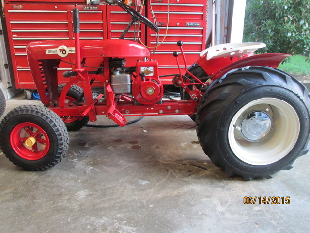

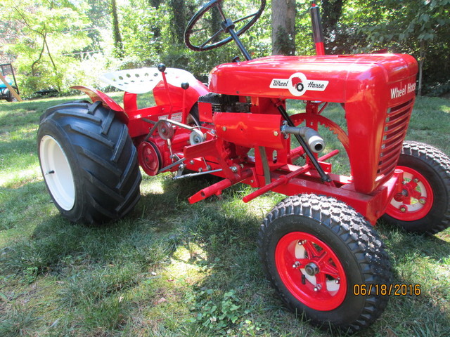

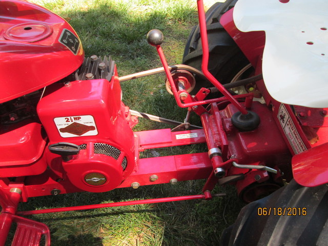

857 horse 2,588 #8 Posted November 1, 2016 (edited) This is what I did,,,with what you have.....and,,,,,mine started with alot less.................I had no idea what a Wheel Horse was..... after 2 years of guessing together a look,,,,i found this sight,,,,,, after some bad guessing,,,,a few good suggestions i wound up with this.. 5 inches longer than my square hoods ...............i give you my,,,,..My 1961 Suburban Edited November 7, 2016 by 857 horse 21 Share this post Link to post Share on other sites

953 nut 70,333 #10 Posted November 1, 2016 (edited) TO If you have a 551 that could well be the original Transaxle, though probably not. That was the first year for the two piece trans. housing, otherwise they were the same as a 401 with a larger engine and electric start. Regardless of what model it started life as it is good to have you here and hope you will share your journey with us. Edited November 1, 2016 by 953 nut 2 Share this post Link to post Share on other sites
jellyghost 378 #11 Posted November 1, 2016 4 hours ago, 857 horse said: This is what I did,,,with what you have.....and,,,,,mine started with alot less.................I had no idea what a Wheel Horse was..... after 2 years of guessing together a look,,,,i found this sight,,,,,, after some bad guessing,,,,a good suggestions i wound up with this.. 5 inches longer than my square hoods .................My 1961 Suburban Well, sorry this happened to you. CLG253, you have been called to do this. The Universe needs another one of these. The 2.5 hp motor is so awesome 5 Share this post Link to post Share on other sites
stevasaurus 23,884 #12 Posted November 1, 2016 (edited) That was Andre the Giant's suburban...a classic horse. It is not often, that I disagree with Walfish, but that trans looks like a regular 3 speed. It could be a 5007 (1961) or a 5025. It looks to me like the brake drum is on the mushroom gear in the pictures. Edited November 1, 2016 by stevasaurus 3 Share this post Link to post Share on other sites
SPINJIM 1,997 #13 Posted November 1, 2016 Big benefit of those mods, you don't have to sit so close to the hot engine. The Suburbans earned their nick names for good reasons. No roasted chestnuts required with the longer frame. Also, nice to be able to use a newer 8-speed trans. Jim 3 Share this post Link to post Share on other sites

RedRanger 1,470 #15 Posted November 1, 2016 2 hours ago, SPINJIM said: Big benefit of those mods, you don't have to sit so close to the hot engine. The Suburbans earned their nick names for good reasons. No roasted chestnuts required with the longer frame. Also, nice to be able to use a newer 8-speed trans. Jim Less chance of flipping over backwards too. No wheelies! 3 Share this post Link to post Share on other sites

wallfish 20,733 #17 Posted November 1, 2016 8 hours ago, stevasaurus said: It is not often, that I disagree with Walfish, but that trans looks like a regular 3 speed. It could be a 5007 (1961) or a 5025 It was a guess about being later based on the shape of the shifter. A 551 trans would have a straight shifter, can't remember on a 701. I also call anything that isn't an 8 speed a 4 speed 1 Share this post Link to post Share on other sites
stevasaurus 23,884 #18 Posted November 2, 2016 You are right about the shifter John, it would have been straight. 2 hours ago, wallfish said: I also call anything that isn't an 8 speed a 4 speed Not true my friend...they also had 6 speeds and 3 speeds and they are different. You might think it is not a big deal, but the linkage is all different for the brakes...on the outside. We do have bigger differences on the inside also. 1 Share this post Link to post Share on other sites
wallfish 20,733 #19 Posted November 2, 2016 1 hour ago, stevasaurus said: Not true my friend...they also had 6 speeds and 3 speeds and they are different. You might think it is not a big deal, but the linkage is all different for the brakes...on the outside. We do have bigger differences on the inside also That kind of information is EXACTLY why we need you Steve! I certainly don't know the trans stuff but... been around long enough to realize there are different models of transmissions. Wasn't really trying to make a point with that comment by meaning that's what they are, it's just my ignorance about them is why it's easier to refer to them that way. Hence, the hiding under the chair. Thanks for straightening me out on that But at the same time, I'm not so sure the exact transmission or linkage information is going to matter one bit for this tractor were talking about. Might be better to discuss how he's going to reach that foot pedal which connects to some linkage first, unless he's 6' 5 or taller. 3 Share this post Link to post Share on other sites

CLG253 26 #22 Posted November 2, 2016 On 11/1/2016 at 8:39 AM, jellyghost said: Well, sorry this happened to you. CLG253, you have been called to do this. The Universe needs another one of these. The 2.5 hp motor is so awesome That is super nice. Does it have good power? 1 Share this post Link to post Share on other sites
857 horse 2,588 #23 Posted November 2, 2016 (edited) Because its 8 gears....it has tons of little ponies torque,,,,,,,,,i can pull my 5x8 trailer from behind the house,,,,to the drive way.....and its a decent slope.....like the guys said.....the nose never comes up.....oh,,and the trailer...,,,it has 14inch tires.....not 12's or 8's....pretty heavy......I need a belt guard,,,i have been called out about this......and I should.....lolololo... Hey,,,,Welcome to the clan,,,,,,,,,,Good group here......the Potato Salad Rocks.....and the dezzert Menu is tah die for......All Pie's lolololo by the way....all the guys talking about your project,,,,I got to meet at our annual BIG SHOW...Steve a souras REX.....and Wall Fish...and at least a dozen other helping hands ..got my project off the ground..i was up and running 1st day by lunch (3day show)......,,,,,,gas,,,,,lug nuts....wrenches,,,a jack......a tee shirt,,,and several bottles of water....((( I left all my shirts at home ))),,lololol and I NEVER ASK FOR A SINGLE THING,,,,THE OFFERS OF HELP WALKED UP AND GAVE OF THEM SELVES,,WLLINGLY,,,, Dont get me wrong.....this can be a tuff crowd ,,, a mixed bag that works.....Welcome to a new home for you and your Horse.....Your back is covered....!!!!!!!!!!!!!!!!!! Howard857Horse in Va Edited November 3, 2016 by 857 horse 2 Share this post Link to post Share on other sites
CLG253 26 #24 Posted November 7, 2016 What is the big hole in the hood under the steering wheel for? Share this post Link to post Share on other sites
wallfish 20,733 #25 Posted November 7, 2016 (edited) Not sure of it's original design purpose but there was a plug in there which was used to mount the key switch for a 551 or just a shut off switch for a 401. A large sheet metal plug like they use for electrical boxes. You can see it on Howard's nice tractor posted in this thread, Edited November 7, 2016 by wallfish 1 Share this post Link to post Share on other sites
