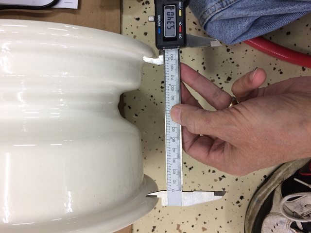

Fun Engineer 863 #4 Posted October 31, 2016 16 6.50 8 measured at the middle of the bead. 4 Share this post Link to post Share on other sites
