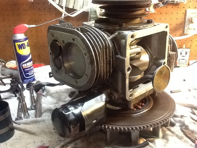

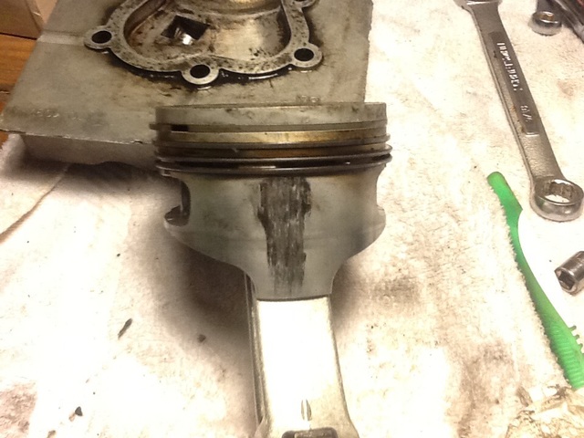

BESTDOGEVER 218 #26 Posted November 8, 2016 Depending on how far up the cylinder it is scored you may be okay mark where the top of the piston is at bottom of the stroke before you pull it out you can then measure to the lower ring and see if the scoring is affecting anything 1 Share this post Link to post Share on other sites
entropy 104 #27 Posted November 8, 2016 It scored at base of cylinder, I think it should be ok. I honed it and it is not nearly as pronounced but still there. Now the problem is finding pistons for it. Anyone here have pistons for a p218g part # 112-0163? Where did you get yours best? Onanparts does not have them and I have seen used on ebay.... Share this post Link to post Share on other sites
BESTDOGEVER 218 #28 Posted November 8, 2016 The Cummins dealer here also has Onan parts try Cummins -bridgeway. com . I'm surprised Boomer hasn't chimed in on this. Try Boomers influence. com Share this post Link to post Share on other sites

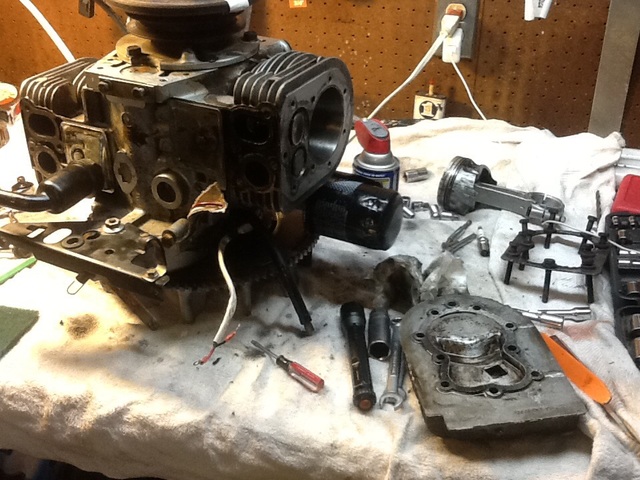

entropy 104 #29 Posted November 14, 2016 Tear down in progress, hoping new(used)Pistons, rings, hone will do the trick. 2 Share this post Link to post Share on other sites
woodchuckfarmer 333 #30 Posted November 14, 2016 Try www.gphope.com for after market piston assembly. Got mine there for the p220. Wayne 1 Share this post Link to post Share on other sites

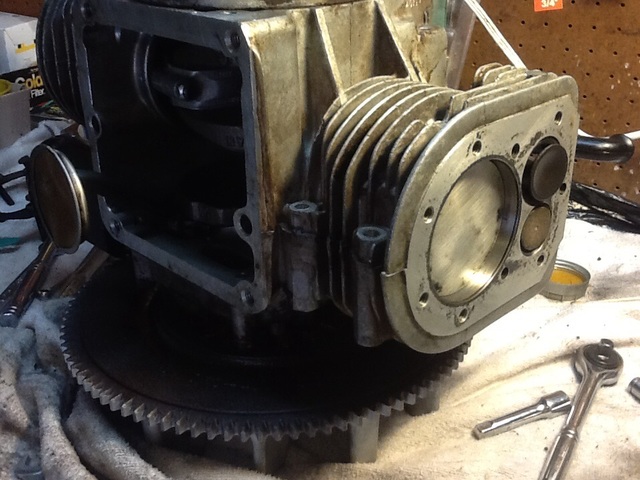

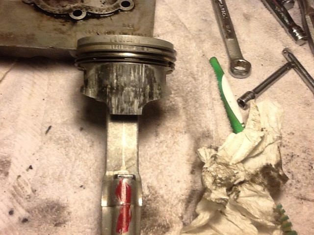

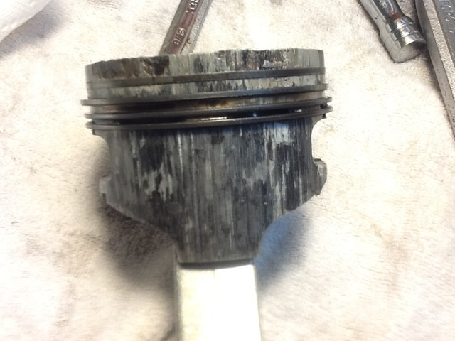

Kurt-NEPA 755 #31 Posted November 14, 2016 Wow, that piston is ugly. I guess you found the source of the oil burning. How does the cylinder look? 1 Share this post Link to post Share on other sites
BESTDOGEVER 218 #32 Posted November 14, 2016 My thought exactly, how the cylinder didn't get trashed is a minor miracle Share this post Link to post Share on other sites
entropy 104 #33 Posted November 15, 2016 (edited) Right?! Cylinder wall had some grooves at base near crank and when I rotated crank and got piston to low spot of stroke it appears that the all the rings stay above the grooves. After honing the groves are much less pronounced but still there. I ended up pulling the other piston as well due to skirt being scratched up. I think I will probably have to replace that one as well, but the rings and top of the piston are not as damaged as the rear piston. What do you guys think? Edited November 15, 2016 by entropy Share this post Link to post Share on other sites
Kurt-NEPA 755 #34 Posted November 15, 2016 Wow those pistons are ugly. Have you measured your cylinders? If the cylinder are in spec, I think I would replace the pistons and rings and give it a try. Share this post Link to post Share on other sites

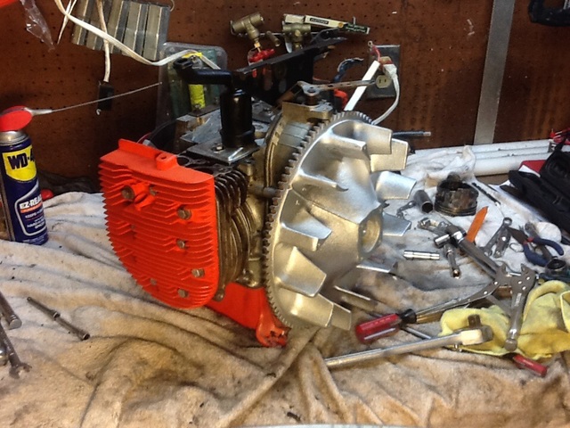

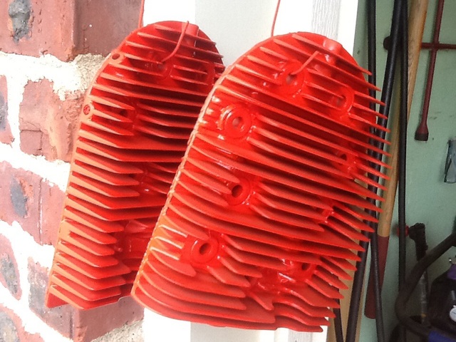

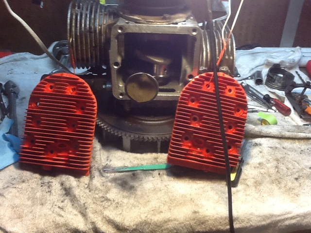

entropy 104 #37 Posted November 16, 2016 (edited) What do you guys think about the redheads? Don't tell the wife! Edited November 16, 2016 by entropy 3 Share this post Link to post Share on other sites
WHX?? 52,677 #38 Posted November 16, 2016 1 hour ago, entropy said: Don't tell the wife! Not a word! Looks good ...be something different fer sure! Share this post Link to post Share on other sites

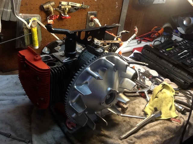

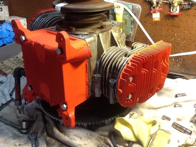

entropy 104 #39 Posted November 18, 2016 Pistons back in and con rods torqued to crank. Time to reassemble and hope for the best. 3 Share this post Link to post Share on other sites
wrightorchid 261 #40 Posted November 18, 2016 It's like a Ferrari Testarosa!! Share this post Link to post Share on other sites
entropy 104 #41 Posted November 18, 2016 (edited) 3 hours ago, wrightorchid said: It's like a Ferrari Testarosa!! BINGO! Edited November 18, 2016 by entropy 2 Share this post Link to post Share on other sites

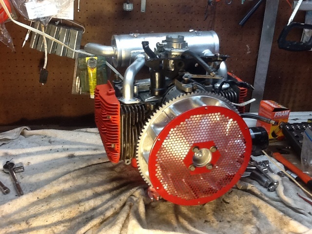

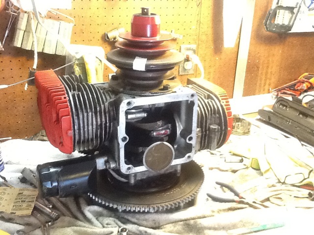

entropy 104 #42 Posted November 18, 2016 Used header paint from auto parts store to bling motor Share this post Link to post Share on other sites

WHX?? 52,677 #45 Posted November 28, 2016 If that power plant runs as good as it looks you are gonna be in like Flynn! 1 Share this post Link to post Share on other sites

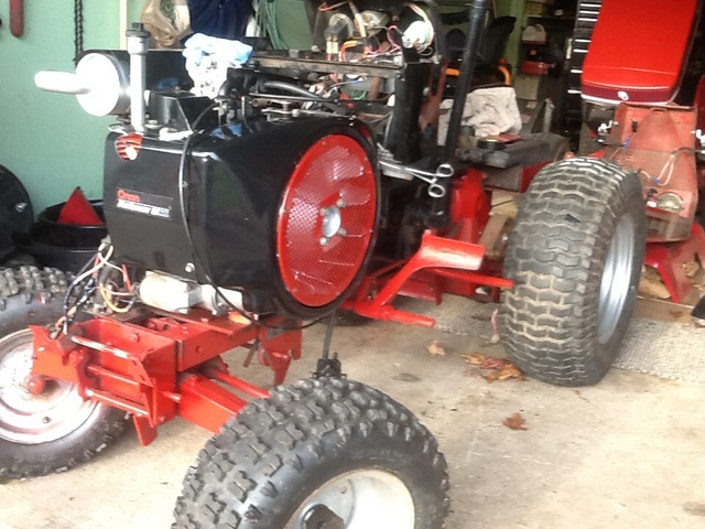

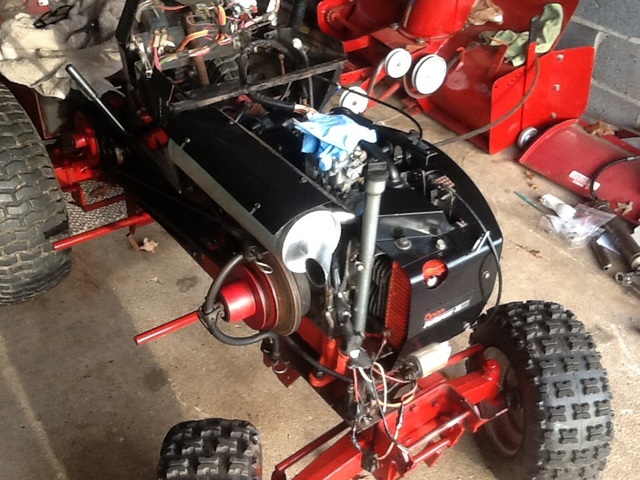

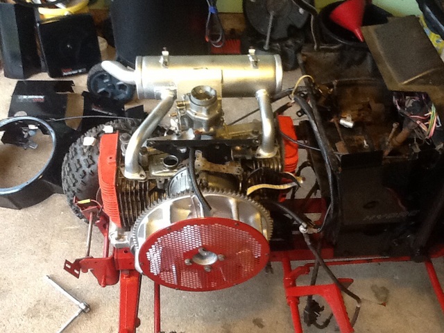

entropy 104 #46 Posted November 29, 2016 Dropped motor in frame, nothing torqued down yet. 2 Share this post Link to post Share on other sites

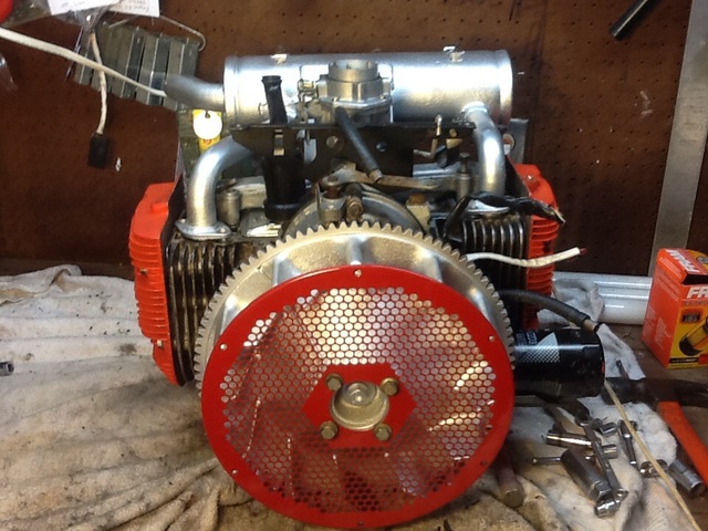

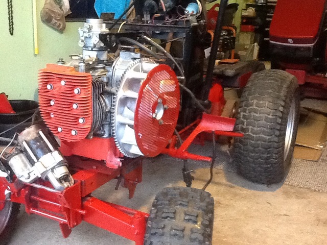

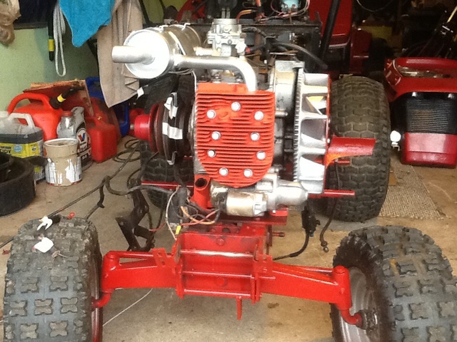

entropy 104 #47 Posted December 4, 2016 Inching closer to adding oil and gas. 5 Share this post Link to post Share on other sites
woodchuckfarmer 333 #48 Posted December 4, 2016 I'm wounding how its going to run ? Wayne Share this post Link to post Share on other sites
entropy 104 #49 Posted December 4, 2016 Ran well before tear down, minus the prodigious oil burning! My hopes are it will run like a champ but you never know..... 1 Share this post Link to post Share on other sites
WHX?? 52,677 #50 Posted December 5, 2016 Amazing how big that starter looks in the 1st pic! Share this post Link to post Share on other sites
