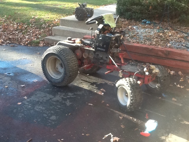

Walt 339 #15 Posted October 31, 2016 I notice the oil pan under tractor in your pictures how much leaks and is leak faster when running and oil is under pressure it may not burn as much as PO was thinking it is. Share this post Link to post Share on other sites
entropy 104 #16 Posted October 31, 2016 That was just me draining old out and putting fresh in to see if it made a difference. Been pricing out parts and costs for rebuilding and that is quite the shocker as far as $$$ goes. If I had all the tools and supplies as a starting point it could be worth it to tear into motor, but starting out from nothing the price is prohibitive for rebuild. Perhaps if I found a good deal on a used motor a transplant would make sense, otherwise it seems to steep. A rebuilt motor is ~$1500......good lord! 1 Share this post Link to post Share on other sites

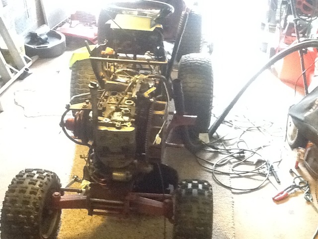

entropy 104 #21 Posted November 6, 2016 Made my decision. Lower compression on rear cylinder. Valves and whatnot look OK from an eyeball perspective. When it was running sounded smooth, no piston slap or such. I am going to just remove motor, drop oil pan and pull the one piston and head, hone and new rings and see what happens. If I feel adventurous may remove other piston as well and do same as other side. If motor is trashed( do not think so as it runs well, just burns oil) then I will keep wear parts and part out rest. 2 Share this post Link to post Share on other sites
entropy 104 #22 Posted November 7, 2016 Getting ready to crak open motor and see what is what. Have all the tools I need thanks to neighbor who is a mechanic. I will hone and rering if it looks good when I open it 3 Share this post Link to post Share on other sites

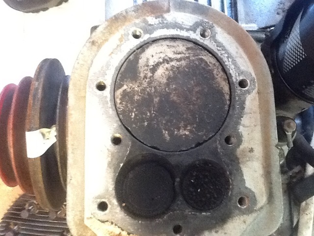

entropy 104 #23 Posted November 8, 2016 Just pulled head and do not want to be dramatic but, UH OH! This does not look promising........ Going to drop oil pan and pull out and see what I have. There was a bunch of motor oil coating cylinder as well. If I am lucky maybe it will be the type of piston where you can just replace the one and not unbalance motor. Not sure of the roundness of cylinder either as you can see light on area near valves when piston is bottomed out in cylinder...... That would be the end of this onan for sure Share this post Link to post Share on other sites
BESTDOGEVER 218 #24 Posted November 8, 2016 That looks like my onan p218 looked the piston was shot rod was broken crank had aluminum stuck to it. Biggest problem is that the rods now are different so if 1 is broken you may need to get 2 but you can try contacting Boomer if you are lucky he might have one that matches yours if the bore is not scored it might be salvageable Share this post Link to post Share on other sites
entropy 104 #25 Posted November 8, 2016 After going to onanparts.com I have found that both pistons should be replaced to keep motor balanced. The con rods have to be done in pairs(not a biggie since i believe con rods are intact), and I have scoring on cylinder wall at base. If cylinder wall was intact I would probably go for a re-piston/ring on both cylinders, Considering the depth of scoring I am not so sure anymore. In fact I may have 518H parts for sale soon....... maybe Wishin4a416 will start the bidding on the seat..... 1 Share this post Link to post Share on other sites
