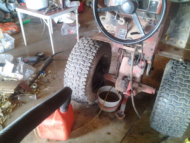

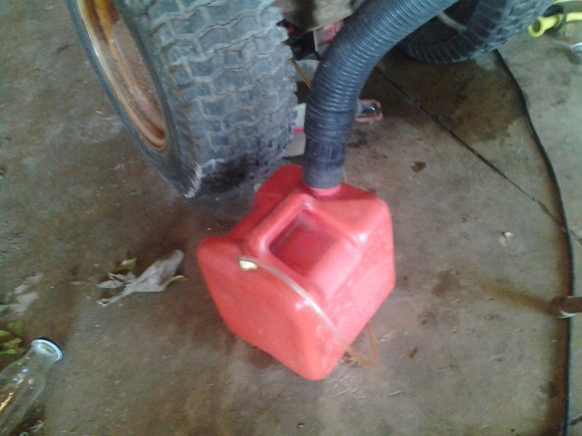

ohiofarmer 3,525 #14 Posted October 31, 2016 (edited) I figured out a way to really get all the old oil out. First, I elevate the front really high by using a hoist fastened to a eye bolt on the ceiling of the shop. So high that the tractor is hitting the hitch on the ground. Now take an old gasoline can that has a nipple style vent and put a little clear vinyl hose on the vent and suck out the remainder by inserting the hose through the transmission hole and connecting a shop vac to the spout on the gas can. About 4 ounces more of old grunge will come out that is the dirtiest part of the oil and may even contain separated water. Let the tractor back down and add some kerosene or Diesel to the transmission and let it set for an hour or so. Elevate the tractor and repeat the draining and vacuum extraction process. Even more old oil containing solid pieces of grit will empty into the old gas container. I was amazed at how much more junk came out using the vacuum. The clear vinyl hose is really satisfying to use as the ugly fluid is clearly visible. On edit: You might want to remove that battery if you crank that front end really high..... Edited October 31, 2016 by ohiofarmer add pics 4 Share this post Link to post Share on other sites
Walt 339 #15 Posted October 31, 2016 8 hours ago, ohiofarmer said: I figured out a way to really get all the old oil out. First, I elevate the front really high by using a hoist fastened to a eye bolt on the ceiling of the shop. So high that the tractor is hitting the hitch on the ground. Now take an old gasoline can that has a nipple style vent and put a little clear vinyl hose on the vent and suck out the remainder by inserting the hose through the transmission hole and connecting a shop vac to the spout on the gas can. About 4 ounces more of old grunge will come out that is the dirtiest part of the oil and may even contain separated water. Let the tractor back down and add some kerosene or Diesel to the transmission and let it set for an hour or so. Elevate the tractor and repeat the draining and vacuum extraction process. Even more old oil containing solid pieces of grit will empty into the old gas container. I was amazed at how much more junk came out using the vacuum. The clear vinyl hose is really satisfying to use as the ugly fluid is clearly visible. On edit: You might want to remove that battery if you crank that front end really high..... Have a few old gas cans on shelf in garage with the vent but the spouts are trashed finally found good use for them. 1 Share this post Link to post Share on other sites
Gunman64 7 #16 Posted November 1, 2016 That's a great idea, I did not think of that. I did use a similar idea when I had a corn stove. i would hook a big shop vac to one side of a 55 gallon drum and the other to a nozzle and suck the corn out of the trailer to the basement. Did not think of using for oil. Thanks Share this post Link to post Share on other sites
