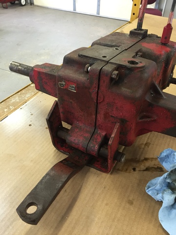

Hello Guys,

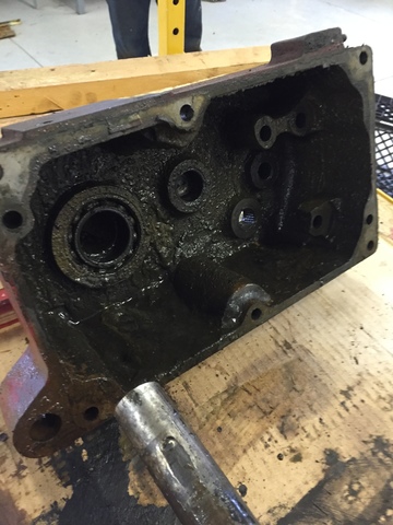

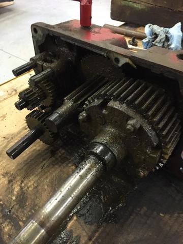

We have been able to get engine running again with a new spark plug and replacing the water/gas with fresh gas. After ensuring it ran consistantly the next step was figuring out why the transmission wouldn't work. We broke it down and started disassembling the uni-drive transmission. One of the issues we were told it had was that it wouldn't take oil. After screwing off the fill tube we found a conical gear oil cap wedged at the bottom of it. God knows how long that transmission was running without oil. Anyways we split the transmission to find a super thick layer of sluge and water. The shifting mechanism was froze, the high low shifter was froze, the two main bearings for the axel shaft were froze and a couple needle bearings had come apart. There was a large amount of corrosion on everything in there.
Long story short I think I'll need a new transmission to make this restoration happen. Does anyways have a lead on a Uni-Drive transmission for a 414-8? Year built is 1988. Any idea on cost?

Try soaking the transmission in some diesel or kereosene. Bolt it back together and try shaking it. I usually do it a few times (2-3) until the fuel comes out fairly clean. It is worth a shot to see what it can do before saying it is completely shot.
After that try some simple green and a brush to clean it further.
From there I believe you can get the vast majority of the parts especially now that the 1533 bearings are available here.
Edited by mmmmmdonuts
Kleinrrr
 I ended up power washing out that sludge. I don't think the diesel will help with my bearing and seal issue. Replacing all them is a hefty price tag but that seems to be the only way to do it right.

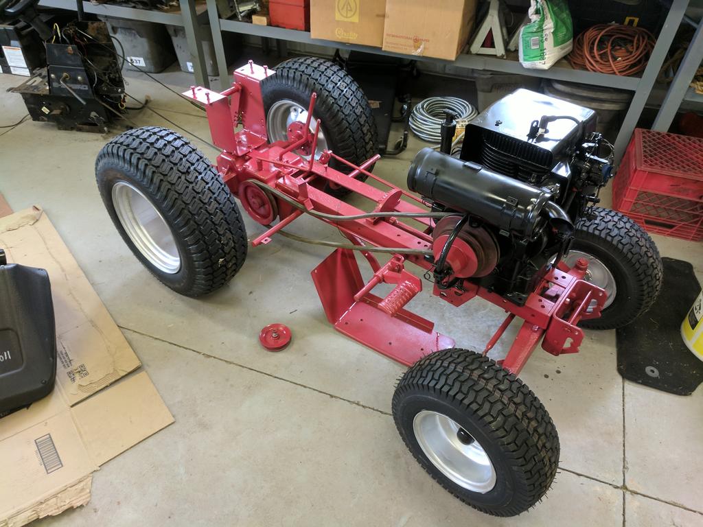

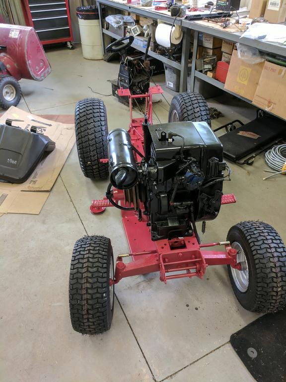

Kleinrrr
Started assembly on the 414-8.
Edited by Kleinrrr
  • Like 3
