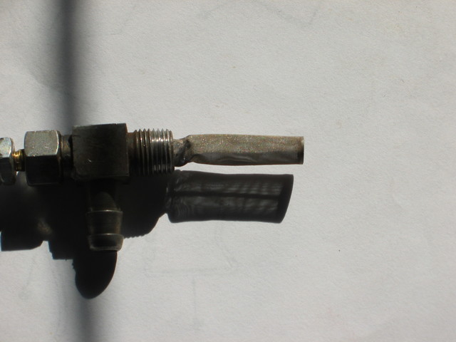

clueless 3,405 #7 Posted October 29, 2016 My wheel horses and my simplicity all came with a filter on the shutoff valve in the tank, no external filter. I always put a inline filter on any of may stuff, but curious as to what micron count the filter in the tank is. While an inline external filter is cheap and easy to install, is this over kill, the manufacturers didn't think it was necessary. Share this post Link to post Share on other sites
pfrederi 20,675 #8 Posted October 29, 2016 It is just a screen. I have no idea what the micron rating would be...but the sun shines through it pretty easily...of course the holes in it are finer than anything in the carb. But I put paper in line filters on all my units. Hard to tell if the screen in the tank has been compromised with out pulling it to check. Share this post Link to post Share on other sites
Detector 72 #9 Posted October 29, 2016 (edited) IMO I think it's just cheap insurance, I've seen plenty of those screens rot away over time, the one on my WH had a tear in it but it also had a clear inline fuel filter on it that was full of small particles mostly bits of old fuel line which could had ended up in the float needle or jet, I washed out my tank and replaced everything for under $35, peace of mind I suppose... Edited October 29, 2016 by Detector Auto correct... Share this post Link to post Share on other sites
