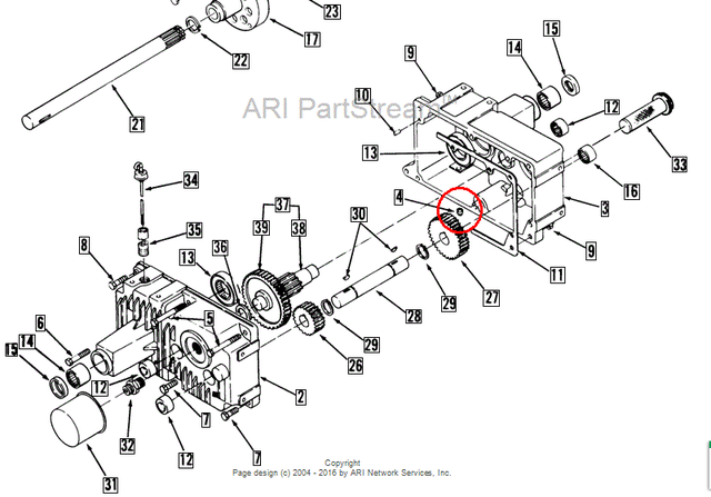

Jim Leh 7 #1 Posted October 28, 2016 Hi, Jim Leh here in Chebooygan, Mi. I have a c141. 1979 automatic with Sundstrand transmission. I have searched everywhere ( including here), to find out how to drain the hydrostatic fluid. The unit operates perfectly, but when I got it the fluid level was very low(but clean) and it has a non wheelhorse non Napa filter on it. I want to replace both so I'm assured its proper. So, how do you drain the fluid? Thanks for the help. Jim Share this post Link to post Share on other sites

benji756 342 #4 Posted October 28, 2016 there may be a drain plug on the bottom or on the side close to the bottom that takes a allen wrench and the hole is filled with grease or crap so you don't see it. possibly on the left rear near the hitch Share this post Link to post Share on other sites

953 nut 70,056 #10 Posted October 28, 2016 One other consideration, you should jack up the front of the while draining to ensure complete emptying. The casting has a hump in the middle which will trap part of the old fluid if you don't. 2 Share this post Link to post Share on other sites
pfrederi 21,274 #11 Posted October 28, 2016 (edited) It should take a 1/4" Allen wrench to open the drain. As indicated above it is probably packed with junk and hard to see Edited October 28, 2016 by pfrederi 1 Share this post Link to post Share on other sites
