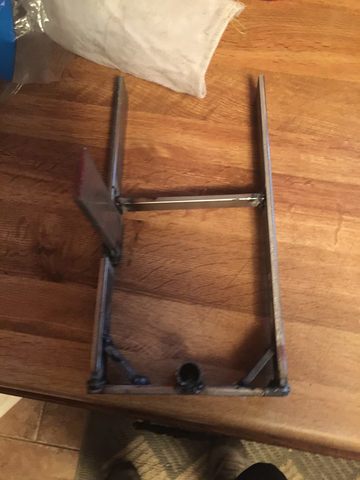

bbuckler 45 #1 Posted October 28, 2016 No internet over the weekend had lot of free time so I tried my hand at building a sleeve hitch for my c-120. I still got more to do on it before I'm finished. 6 Share this post Link to post Share on other sites
Achto 32,845 #2 Posted October 28, 2016 Looks like you have an awesome start there! Don't forget to add some stopper bolts on each side of the sleeve. Specially if your going to use a plow. 2 Share this post Link to post Share on other sites

bbuckler 45 #4 Posted October 31, 2016 I made the back holes to big I drilled them out at 7/8. Also got to fix a couple of the welds my welder don't like the electric at the barn. I haven't worked on it anymore I don't have any sleeve hitch attachments to try it out. Share this post Link to post Share on other sites
