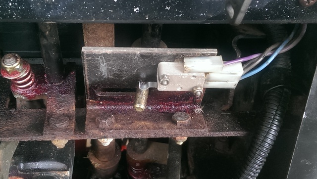

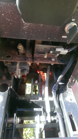

WVHillbilly520H 10,379 #7 Posted October 28, 2016 Double check that neutral switch on the the 520 I bought this spring I went crazy tracking down an electrical problem that was mechanical, the actuator was missing top pic, new second pic,Jeff 2 Share this post Link to post Share on other sites
