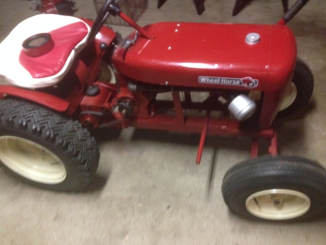

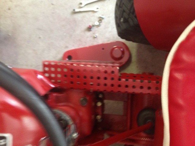

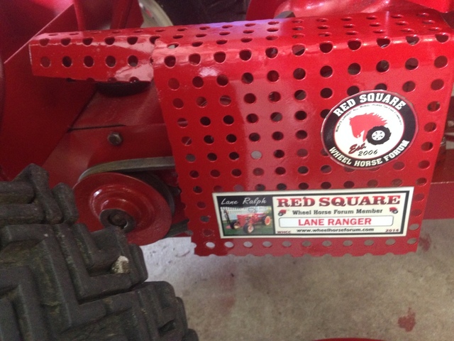

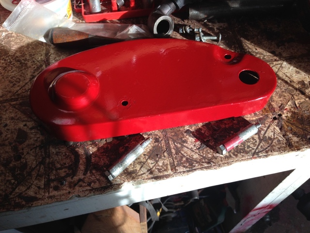

Lane Ranger 11,813 #1 Posted October 26, 2016 Finished making the new belt guard I needed for my 1958 Wheel Horse RJ I restored! The guard normally used on this would not mount correctly as I needed a belt guid to assist the clutching on this tractor. The belt guide needed to mount in the Kohler motor threaded hole that the right side bolt for the RJ belt guard! So I used perforated plate to make a belt guard that would protect your right leg from getting into the idler pulley and Drive belt. Came out pretty good and the one inch hole spacing on the perforated sheet metal matched up perfectly with the wheel horse holes. The belt guide did not work correctly on the bottom of the motor (first picture) so I had to use the top left hole on the motor for the guide . 7 Share this post Link to post Share on other sites

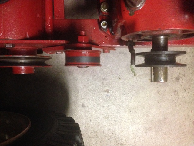

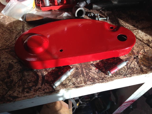

wallfish 19,333 #3 Posted October 27, 2016 I see the correct belt guard there on the floor. Maybe getting that idler pulley spaced out a little or moving the other pulleys in to line them all up will help it work. Seems a shame not to use it on that nicely restored tractor. Could just be the pic is deceiving in the alignment of them. Belt looks loose on there too. 1/2" x 29" belt for the RJ. Some can be a real pain to get working correctly. Just ask @Ken B, we played with a Suburban belt for a while at Stevebo's M&G last Sat. 2 Share this post Link to post Share on other sites

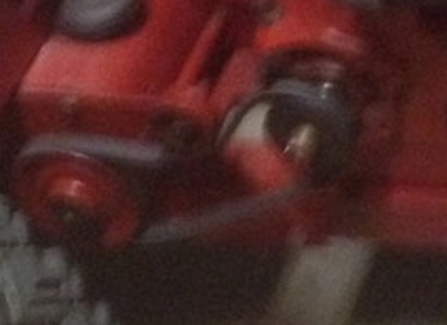

Lane Ranger 11,813 #4 Posted October 27, 2016 John: I also thought I might try another belt but did not get around to it. In the [pic you drew the line on you can see the belt guide in the lower part of the motor . This is a threaded bolt with a nut on it to tightened up in one of the Kohler K 91 bolt holes. I think the second photo the belt is loose which is why I put the belt guide on it. The pulley alignment may not be perfect but appears pretty good. It would not work to tighten up the blet in the lower location but would in the hole on top -directly above the one in the photo. This belt was a new Wheel Horse RJ belt ( #1561 belt) but I have used NAPA 248-029 belts on my other RJ's and they worked great. I guess I should try another belt out . Share this post Link to post Share on other sites

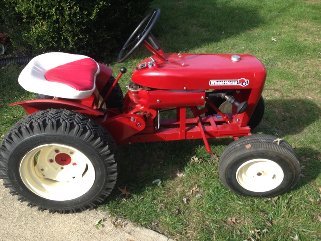

Ken B 3,202 #5 Posted October 27, 2016 (edited) When I installed an 8hp electric start Kohler on my sons Suburban I made a custom belt guard from scratch for it. I put different pulleys on it to make it a little faster. I must have got lucky because the first time I tried it it worked perfect... Edited October 27, 2016 by Ken B 3 Share this post Link to post Share on other sites
Lane Ranger 11,813 #6 Posted October 27, 2016 Thanks Ken. Looks great. Looks like you used the upper right hand bolt hole to place the guard in . My guard I made goes up a little higher and goes over the left hand hole on the top of the Kohler as that is where the belt belt guide is bolted in. Share this post Link to post Share on other sites

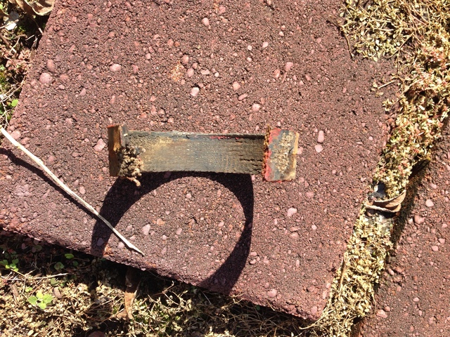

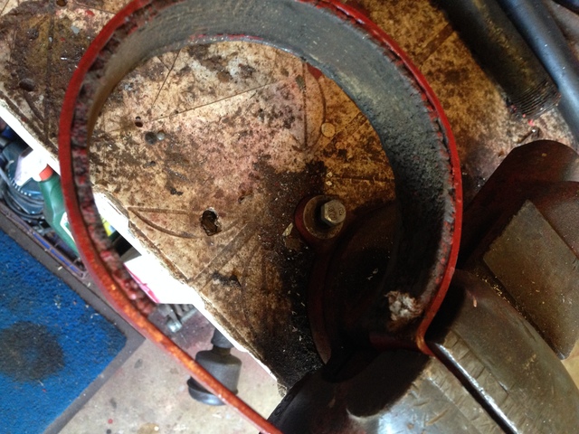

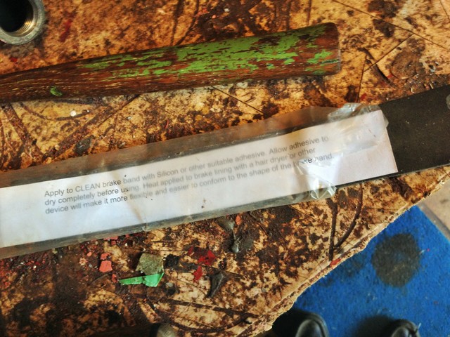

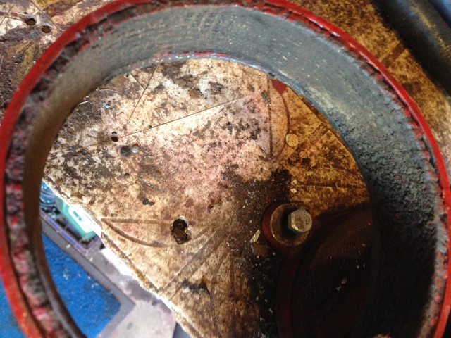

Lane Ranger 11,813 #7 Posted October 28, 2016 (edited) John/Ken and other Red Square Members: I think I found the source of my belt guard problem. I decided to go back and look at this RJ belt and compare to the two others I have to see what was happening as I started to clutch to change gears and brake. I noticed that without the belt guide the clutch/brake on the tractor was not stopping the transmission! I recalled that I had reglued to original brake band on the brake shoe but I did not recall testing it to see if it stopped the transmission pulley from turning and thus the drive belt. Well I took off the brake band and could readily see that it had worn the surface down so far that it could not grab the brake drum on the tractor. So I am reshoeing the brake band with one of the bands Bob Maynard makes and sells and going to reinstall tomorrow. I believe that the new band will solve my belt issue and thus I should be able to reinstall my regular RJ belt guard. Edited October 28, 2016 by Lane Ranger 1 Share this post Link to post Share on other sites

Lane Ranger 11,813 #9 Posted October 30, 2016 (edited) The RJ Wheel Horse brake band needed changing and I can use my RJ belt guard! I had to use another old RJ brake band to make the transmission clutch properly to stop the drive belt and clutch properly. After changing I could use the original tyoe RJ belt guard and everything is working as intended! Runs and shifts great now! Short video of everything in operation! 004.MOV Edited October 30, 2016 by Lane Ranger Share this post Link to post Share on other sites
