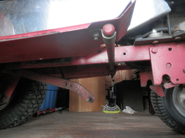

Paul Moore 7 #1 Posted October 26, 2016 I have a 520-H. When I tried to put the plow on, I found that the hole that the pin on the lift arm goes through is to small. I noticed that this is removable. Is there another adapter that is big enough to fit? Or do I just have to drill it bigger? Share this post Link to post Share on other sites

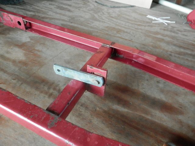

gwest_ca-(File Mod) 12,461 #2 Posted October 26, 2016 Welcome to the forum. The pin in the lift arm is not used for the dozer blade - mower decks only. You need a short lift link to connect to that arm or a long lift link to go up to the lever on the rock shaft. The long link does not work well for the hydraulic lift models. The only float allowance is in a slotted hole in the plow lift bracket but it does allow for down pressure on the blade. Short lift link shown on page 6 Garry 1 Share this post Link to post Share on other sites

Paul Moore 7 #5 Posted October 26, 2016 Here's the lift arm and plow. There's a hole further back on the lift arm. Will that work? Share this post Link to post Share on other sites
WVHillbilly520H 10,379 #6 Posted October 26, 2016 (edited) Yes sir in that hole, that's exactly where the silver short link pins into on the lift lever, it uses a 3/8" diameter clevis pin or bolt just like it's pinned to the blade frame with, Jeff. Edited October 26, 2016 by WVHillbilly520H Share this post Link to post Share on other sites
varosd 1,185 #7 Posted October 26, 2016 also to get that extra lift you may need to change where the trunnion (20) goes into (19) 2 Share this post Link to post Share on other sites
Tankman 3,528 #9 Posted October 27, 2016 Lift links come in two lengths. 2 Share this post Link to post Share on other sites
