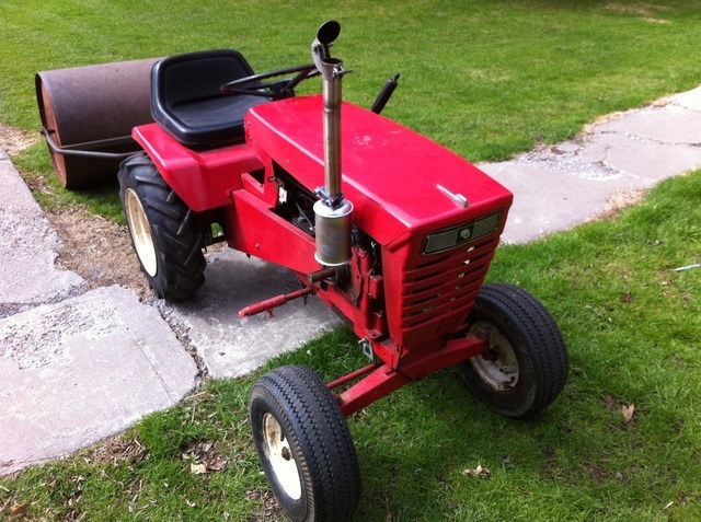

clueless 3,405 #5 Posted October 27, 2016 Gentlemen, thanks for your help but I know where to buy them, my question was can it be used ether way, inlet used as the outlet, outlet as the inlet, reversed from how you have them mounted? Share this post Link to post Share on other sites
Fun Engineer 863 #6 Posted October 27, 2016 (edited) The pipe sizes are diff. Will that help determine whether you can use either end? 1 1/4" outlet 1 5/16" inlet Edited October 27, 2016 by Fun Engineer Share this post Link to post Share on other sites
CasualObserver 3,416 #7 Posted October 27, 2016 2 hours ago, clueless said: Gentlemen, thanks for your help but I know where to buy them, my question was can it be used ether way, inlet used as the outlet, outlet as the inlet, reversed from how you have them mounted? Sorry, I haven't run it backwards but can offer this reasoning.... Installing it normally is stepping down from 1-5/16 at the inlet to 1-1/4 at the outlet creating slight backpressure. Going the other way will likely reduce that. I don't think our small HP engines really rely that heavily on the backpressure anyway. Share this post Link to post Share on other sites
