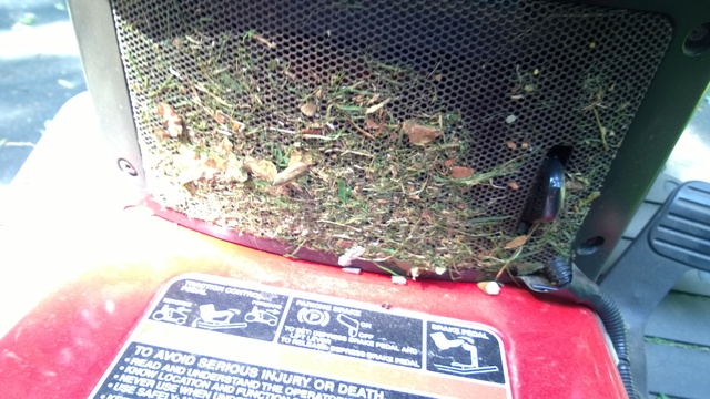

DennisThornton 4,773 #13 Posted October 25, 2016 From what I've gathered the Eaton 1100 is the best hydro WH ever used, the best there was at the time, perhaps the best there is in that category. I sure like the 2 speeds! I have both Kohlers and an Onan and again, from what I've gather both are top notch, but perhaps the Onan was not as good a match for "lawn mowing" and doesn't shed leaves and grass clipping as well, a fact that I can indeed attest to! And many have suggested that issue has caused most of the woes Onans have while powering the WHs. Combine the reduced incoming air with the restricted outgoing by the belt guard and one cylinder can overheat. The static debris guard on the Onan does seem to make a GREAT leaf catcher with every leaf you pass over trying to jump out of the sweep of the blades and land on it. I must repeatedly rise up and wipe off the collection every few minutes where the Kohler's rotating debris guard flings off the desperate leaves to once again take their chances. So my first choice for a WH would be a Kohler pushing an 8 speed! Second choice a Kohler pushing an Eaton 1100. My 416H Onan will have a task other than mowing! Seriously! I would NOT make it my mowing machine! It collects leaves and grass that bad! Others have dealt with it as a mower but I have other mowers... 30 minutes ago, jdleach said: I am certainly not an expert on Wheels Horse autos, but can attest to the durability of the Eaton 1100. My C175 is about as worn out as a tractor can be and still run. Tach-Matic hitch points, brake lining, front spindles, wheel bearings, you name it. The one thing that appears to be good at this point is the Eaton hydro in it. All the blades were broken off of the cooling fan, and the oil and filter looked to be original, yet it still feels strong. Man that could be a Timex style ad for Eaton! Seriously, that is a GREAT way to explain to "us" that your Eaton has taken a beatin' and still keeps on pushing! Especially that "All the blades were broken off of the cooling fan" phrase! I have just recently added a 264 to the herd, and while I like it a lot for good reasons, I will expect less of it than other's in the herd. The PO told me the Tuff-Torq trans got into some mud and overheated to failure. So note that Toro's price point offering, the 2XX series did NOT use the Eaton! Thanks for sharing! 3 Share this post Link to post Share on other sites

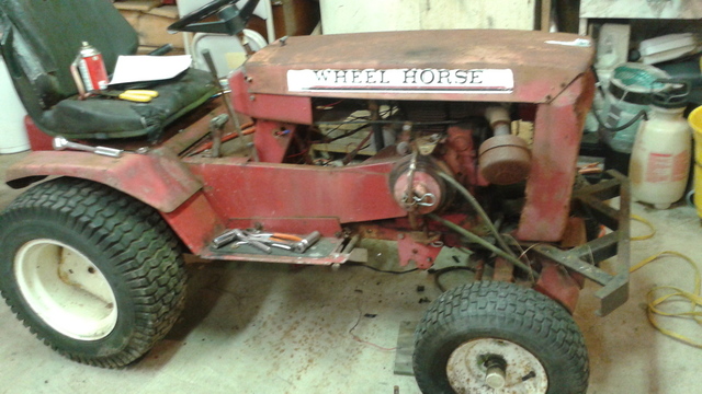

DennisThornton 4,773 #21 Posted October 25, 2016 Hard for me to say... Would be nice to see more red paint instead of red rust... Though is sure seems like you could build one nice one and have lots of spare parts! If you have the time and DON'T expect to get paid nicely for your time then sure! Or sell off some parts and build with what's left. Are just looking for a workhorse? Or a showhorse? Lot's of work to get a showhorse! Maybe not so much for a workhorse... Share this post Link to post Share on other sites
