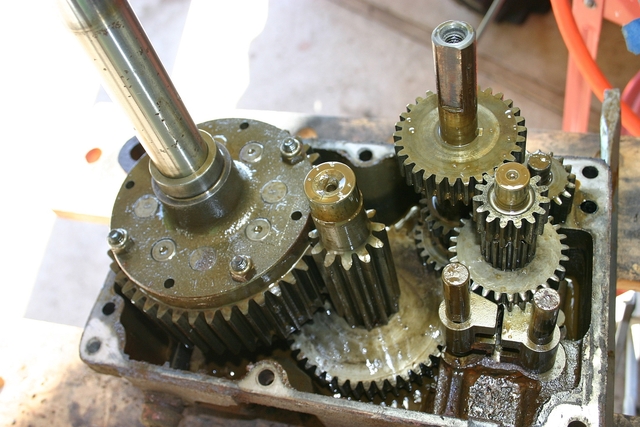

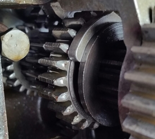

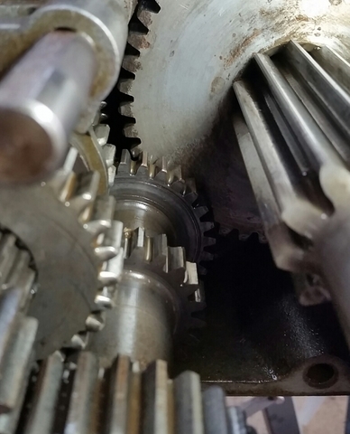

Texas Todd 1,026 #27 Posted October 24, 2016 Well I have the patience of a squirrel. Got the case separated. About an eighth inch of water still in there. I got some cleanin to do.... How do we go about checking the third gear movement issue (I think that's why I did this ) 2 Share this post Link to post Share on other sites

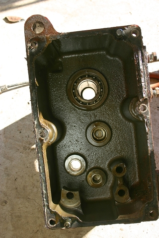

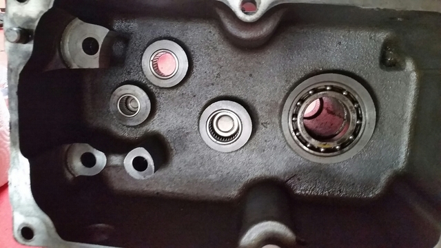

stevasaurus 23,662 #28 Posted October 24, 2016 WOW...after seeing your shifter, I would have never guessed that your trans would look this good. I would put my finger in those bearings in that case and see what it feels like. Don't go crazy here...just see if the bearing seems free and maybe use some penetrating oil to clean the bearing out...no need to pop the bearing out of it's seat. Do not use brake cleaner or carb cleaner here...or WD40 (which is just a water displacement)...use a good penetrating oil...PB blaster or such. That ball bearing is the #1533 bearing I was talking about in the PM. It looks like you just may need to replace seals at this point. I would finish taking the trans apart...it does look like you may have some rust. Your call here, but you came this far... 1 Share this post Link to post Share on other sites
Texas Todd 1,026 #29 Posted October 25, 2016 (edited) Well after a nice long conversation with @stevasaurus we fixed many of the problems of the world and even discussed transmissions. While he encouraged me to dismantle the entire unit, I decided I had come far enough in this wanderlust. Me a wire brush and a turkey baster spent some quality time and I do believe the transmission (on the inside) is shining like a diamond in a goats rear. Now if the man in the little brown truck will bring me all my gaskets and seals, I can button this up and go to work on the case. I have to admit, it's kind of neat to be talking to a guy as knowledgeable as @stevasaurus while you are looking at the transmission and he is not and he describes how everything works and what gear was which and even which gear I was in. He described how to shift it to neutral, without the benefit of a stick......Pretty cool, and much appreciated. Once I get this thing buttoned up, I will close this out. The restoration thread can be found here: Edited October 25, 2016 by HD-Horse sic 3 Share this post Link to post Share on other sites
