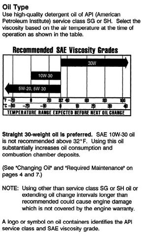

Ed Kennell 46,055 #6 Posted October 22, 2016 (edited) The manual actually states: above 30F use 30W 0-30F use 10W30 below zero use 5W20 Edited October 23, 2016 by Ed Kennell 4 Share this post Link to post Share on other sites

pfrederi 20,532 #12 Posted October 23, 2016 12 hours ago, Ed Kennell said: The manual actually states: above 30F use 30W 0-30F use 10W30 below zero use 5W30 I read it as below 30 you can use either 5w-30 or 10w-30 when it goes below zero 5w-30 is prefrred 2 Share this post Link to post Share on other sites
Ed Kennell 46,055 #13 Posted October 23, 2016 This is from the OP manual. 1 Share this post Link to post Share on other sites
