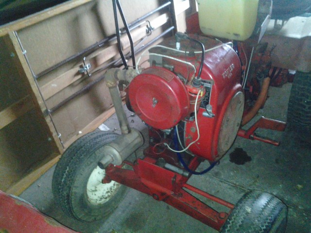

ohiofarmer 3,492 #10 Posted October 26, 2016 (edited) Welllllll ! I finally figured out how to load a file off my cell phone. this is the Electro 12 To make it run, i stole the coil pack off the Raider10 and ran a jumper to the battery. the points were on the tractor, and i used a new condenser. The conversion will not be complete until I replace the switch. that also requires an additional solenoid as the present switch wires direct to the starter post. The coil or mag that the engine had was actually part of the stator and I could not remove it, so i just cut the spark plug wire. I may have to also replace the stator, but we will see. What is weird is this engine has both breaker points and a condenser. If the picture is not too crappy, I will take pictures of all three tractors, The tractor in this photo has an Hydro transmission and will probably get the engine from the Raider10. The C-121 will probably stay intact and get a mower transplant from the Raider. I measured the play in the transmission of the Raider10 and it is about 9 inches. I am sure to have more questions later on, but for now, I need to finish out the mowing season before tearing anything apart Edited October 26, 2016 by ohiofarmer 1 Share this post Link to post Share on other sites
953 nut 69,551 #11 Posted October 26, 2016 Sounds like you are doing very well. This diagram may be helpful. I would recommend adding a 30 amp fuse to the line from the solenoid (battery side) to the ignition switch and a 15 amp fuse to the light switch wire from the "A" terminal. 1 Share this post Link to post Share on other sites
