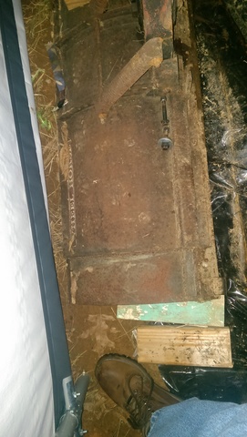

WVHillbilly520H 10,378 #13 Posted October 22, 2016 After straightening, like bengi756 above,have it reinforced with angle iron like this might be a bit hard to see but after I widened a 42" to 50" I used the angle iron to keep it from flexing,Jeff. Share this post Link to post Share on other sites
