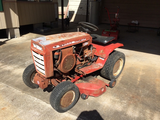

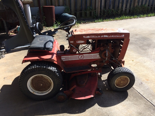

Hacksawhero123 351 #1 Posted October 21, 2016 Does anyone know if a Raider 10 and a 1075 C-160 are the same? From pics they look the same. Thanks. Mark Share this post Link to post Share on other sites

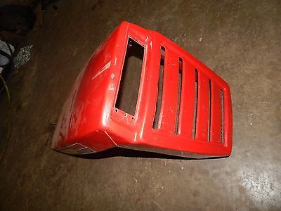

gwest_ca-(File Mod) 12,533 #3 Posted October 21, 2016 The 1969 Raider 10 used a hood with 6x2 grill slots part number 7230. The 1970 on Raiders used a hood with 5 grill slots part number 9699 replaced by 114289 The 1975 C-160 used a hood with 5 grill slots part number 9699 replaced by 114289 114289 2-piece hood and grill joined with four 5/16"-18x1/2" self tapping cap screws and two 105038 grill plates (Suspect it came knocked down to simplify shipping) Garry 1 Share this post Link to post Share on other sites
Hacksawhero123 351 #4 Posted October 21, 2016 I was looking at this hood on eBay. From all I could tell short of running part numbers, (Thanks so much Gwest!) the eBay Raider hood looks like the same as my C160. I'll put a bid on it and see where it goes. Thanks for the help Fellas! Mark Share this post Link to post Share on other sites
