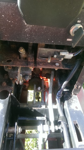

WVHillbilly520H 10,377 #5 Posted October 20, 2016 Here's a couple pics of the linkage from the front to the rear (column shift style), the shift lever has a spring to hold it up while neutral/forward then press to go to reverse this needs " lubed as well as the "ball and hiem joints and pivot points between the front rod and rear rod to cam plate and it's a fine line between too tight and just right on the the "friction" nut on top of the cam plate which should only be lubed with "graphite powder" if so inclined but the roller cam could be lubed lightly with a moly spray lube or similar, is used "red" spray lube, hope this helps,Jeff. 1 1 Share this post Link to post Share on other sites
