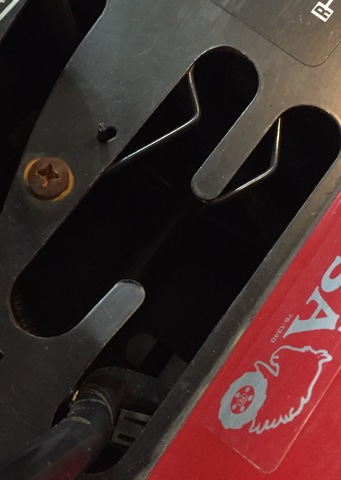

cschannuth 3,821 #1 Posted October 20, 2016 What is the purpose of this spring on a late model 314-8? Share this post Link to post Share on other sites
daveoman1966 3,883 #2 Posted October 20, 2016 Schematic call this the SHIFT CONTROL SPRING and is part # 99-8028. Schematic doesn't disclose purpose... presumably to keep it from jumping out of gear or maybe as an anti-rattle device. Share this post Link to post Share on other sites
cschannuth 3,821 #3 Posted October 20, 2016 Yeah, I saw that on the schematic. It makes it very difficult to shift smoothly. It's more of an anti-shift spring. LOL I'd like to remove it but if it has a purpose I hate to do that. Share this post Link to post Share on other sites

cschannuth 3,821 #5 Posted October 20, 2016 2 hours ago, rmaynard said: Shift smoothly? Are you trying to shift while moving? That's a no no. Tractor should be stopped when moving between gears. If what you are referring to is difficulty placing it in or out of gear, I would try removing it, see if it becomes easier. If nothing detrimental happens, leave it off. No. I only shift when standing still. The spring holds so tightly you have to jerk the shift lever in and out of gear. My other tractors all shift easily in and out of gear and are older so they don't have the spring. I was just hoping that someone had experience with removing the spring and could let me know if it had any negative effect. Share this post Link to post Share on other sites
bmsgaffer 2,071 #6 Posted October 20, 2016 I would bet a lot that this was designed to prevent people from trying to shift it like a car while moving... You can see they put it on the intermediate gears 1 - 3 so it would be hard to quick shift... Share this post Link to post Share on other sites
cschannuth 3,821 #7 Posted October 21, 2016 In case anyone was wondering, I removed the spring and it works well now. In fact, the shift lever itself is spring loaded so it never touches the shift plate to produce rattles. I think Brandon is correct. It was meant to prevent shifting easily while moving (or any other time for that matter). Craig Share this post Link to post Share on other sites
