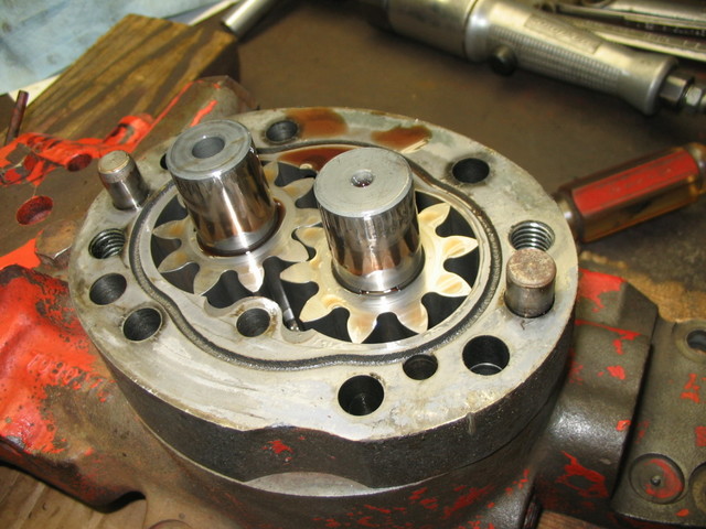

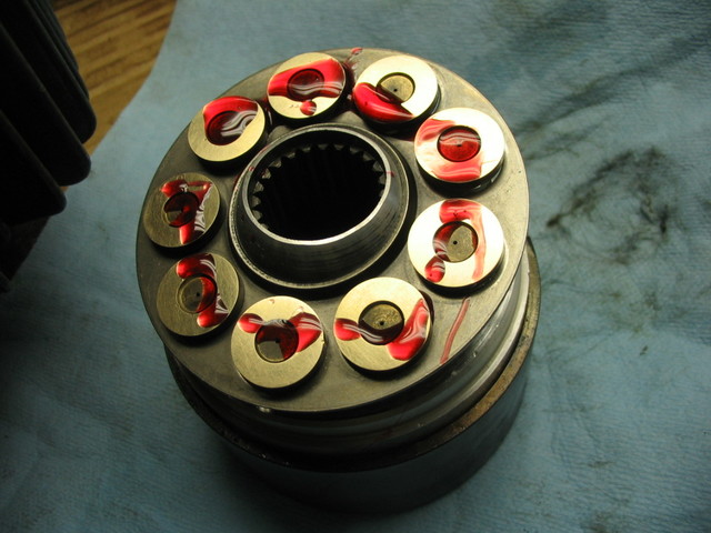

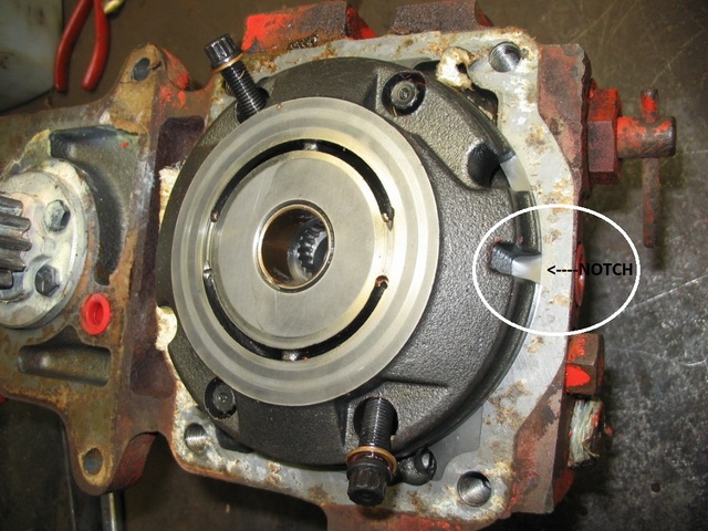

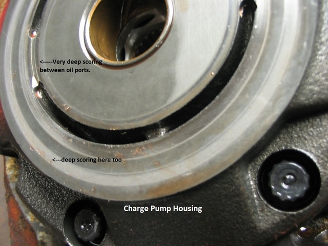

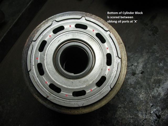

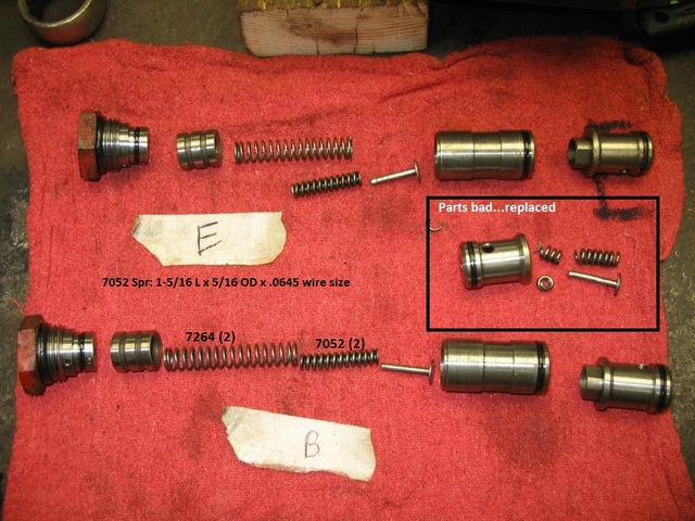

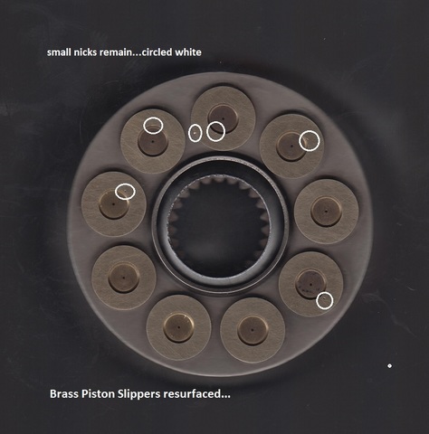

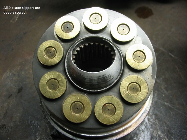

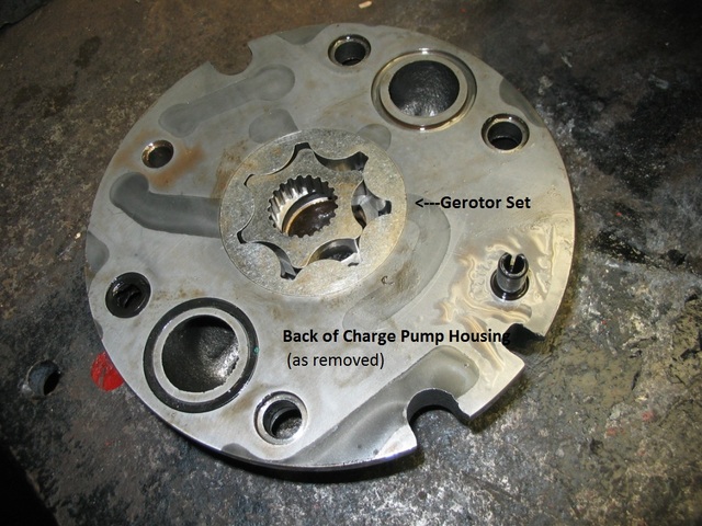

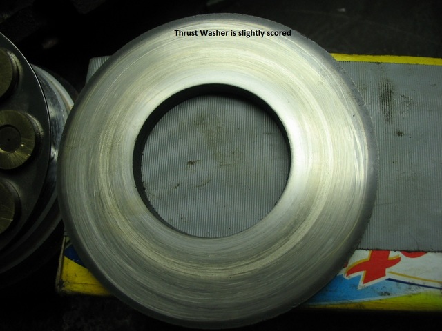

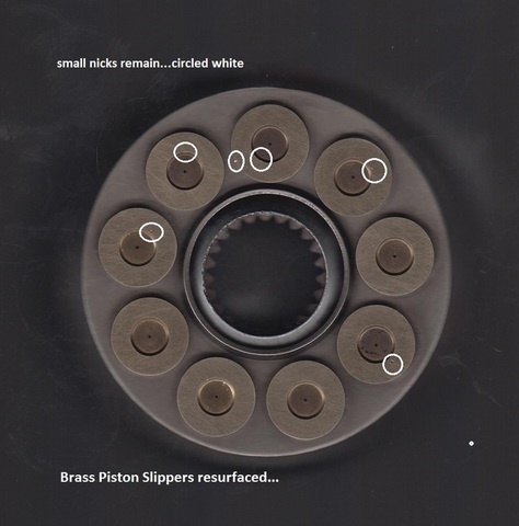

daveoman1966 3,884 #14 Posted October 20, 2016 I'm 99% sure you have a worn out Hydro pump on the Sundstrand Hydrogear model 90-2046. No alternative but to rebuild the pump. The symptoms you describe....ok for 45 minutes, then dies.... is the exact symptom associated with worn out pump. Clean up the ENTIRE AREA, then take the power unit from the gearbox. Once off, remove the 4 bolts holding pump to hydrogear. You will have to refinish the brass surfaces of the piston slippers,charge pump housing, thrust plate, and anyother scratched surface. Here are a few pics of what need to be done. NOTE....there MAY ALSO BE other repair issues with this thing. You should remover EVERY internal valve, spring, oring, etc....all parts to be KEPT ABSOLUTELY CLEAN upon reassembly. You MAY find broken valves or springs, cut o-rings, bent little parts that will effect the performance. It is also a good time to replace all three seals in the pump housing..... It is a long process, but take your time. Above all, KEEP EVERYTHING CLEAN. Send me an off-site email if you want more pics of the internal parts or how to refinish them. my direct email is: daveoman@windstream.net 4 Share this post Link to post Share on other sites

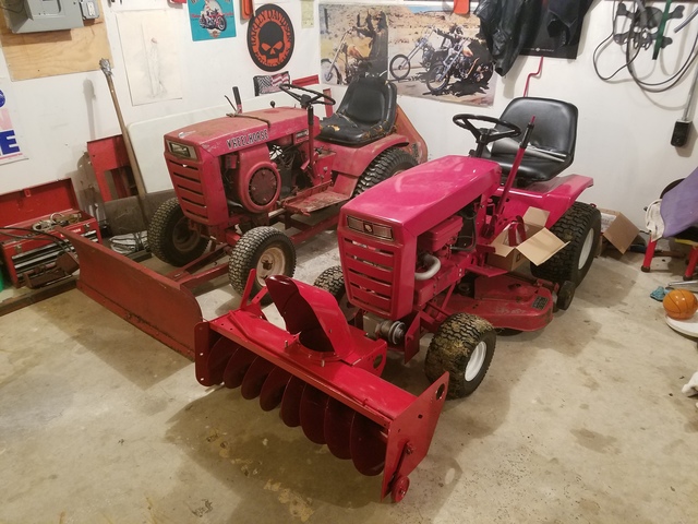

Oberg111 5 #21 Posted October 22, 2016 Thanks guys these are my horses the one on the right is a b111 1979 and the one on the left is a 1971 charger 12 both work and run great I got into these because the one on the right my 1979 was my grandfather's when I got it it was a total mess 6 months ago 1 Share this post Link to post Share on other sites
