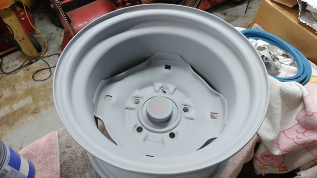

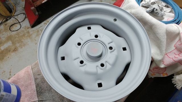

Duramax7man7 506 #26 Posted October 21, 2016 Thanks. Yeah I like the smidge off white. Looks real nice! Here are both sides of the one wheel that has been wire wheeled, sanded, cleaned, rust fixed> Etching Primer> Fill Primer> Sanded> Fill Primer... Just need to sand one more time and EXCHANGE my white for canvas/ off white, then clear coat. It's sitting on a plastic bottle to raise up a bit. This pair of wheels (off of my 1990 520h) are the worst so I think that with the newer set on my 1995 312-8 I will be choosing to paint them after mounting the new tires as I wont need no where near as much prep. Just have to meticulously tape off the tires. Probably when they are deflated still. That makes the most sense. Share this post Link to post Share on other sites

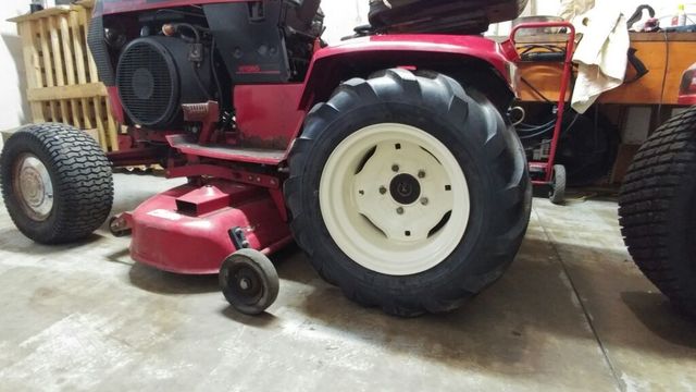

doc724 927 #29 Posted October 22, 2016 Well I painted the front rims today with Rustoleum Canvas White and I second the experience cited by Red Ranger. It is as close to original as I have found. 2 Share this post Link to post Share on other sites

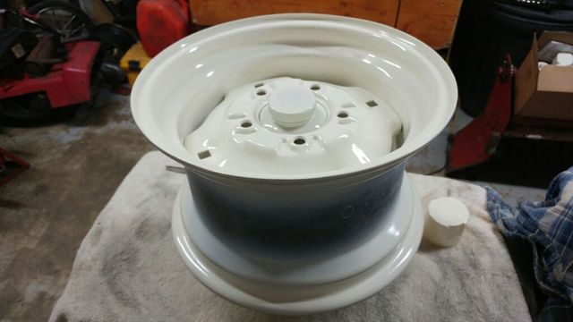

Duramax7man7 506 #31 Posted October 25, 2016 Okay... This is my test rim. 3 coats... will put clear coat on tomorrow or the next day. I kind of like it. I will out the tire on after a few days of curing and then mount it on a tractor to see if I like the combo. What do you all think? 1 Share this post Link to post Share on other sites
Ken B 3,203 #32 Posted October 25, 2016 (edited) I always put the tire on before I paint the rim. I mask the tire off prior to putting air in and then I paint the rim, I also tube my tires. Its impossible not too scratch the rim while putting the new tire on... At least it is impossible for me. Edited October 25, 2016 by Ken B 1 Share this post Link to post Share on other sites
RedRanger 1,470 #33 Posted October 25, 2016 Install the tires from the backside. Then you don't scratch the front. Put some electrical tape on the backside bead to help prevent chipping. Also use a tire lube to slick things up like RuGlyde or even dish soap and water. Those look good. I always apply clear right after the color. Some of the paints have a waiting period before you can recoat if you miss the initial wet coat times. If you respray too soon, the paints may react with each other. Rattle cans also take longer to fully cure. If you can let the wheels sit for a week or so, the paint will be harder to chip. Share this post Link to post Share on other sites

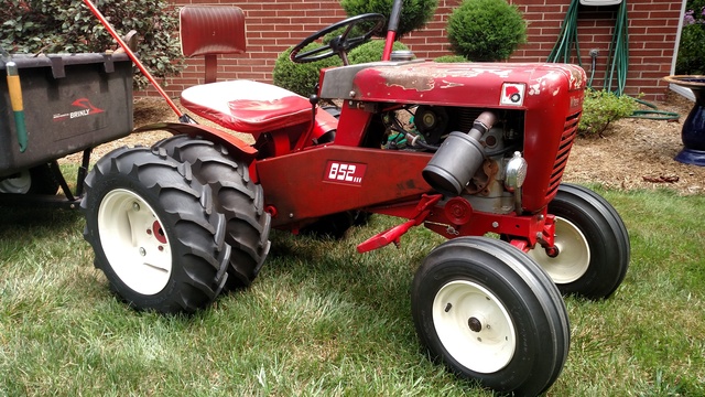

RedRanger 1,470 #37 Posted October 25, 2016 (edited) 11 minutes ago, Mastiffman said: Excellent advice and I will adhere to that... A job done right the first time is a second job avoided... Plus I have a whole other wheel to prep as well as an engine to cleanup. Good idea. Spend your time on something else and rotate back to this in a couple days. It'll still be there. Here's a shot of my latest wheel paint. Did the fronts earlier this year with a rattle can. Did the rear duals with a HPLV gun back in June. Edited October 25, 2016 by RedRanger Share this post Link to post Share on other sites
Duramax7man7 506 #38 Posted October 25, 2016 Yeah those look really nice. I like the dually as well. Will be nice to see mine finally painted and on. Looks like you painted your whole frame as well already? Waht's the brighter coor that everyone seems to lean towards? I like that better than the Cherry Red Rustoleum. Share this post Link to post Share on other sites
RedRanger 1,470 #39 Posted October 25, 2016 9 minutes ago, Mastiffman said: Yeah those look really nice. I like the dually as well. Will be nice to see mine finally painted and on. Looks like you painted your whole frame as well already? Waht's the brighter coor that everyone seems to lean towards? I like that better than the Cherry Red Rustoleum. This tractor was painted a while back by the previous owner. It was a basket case that I pieced together. Belt guard from one tractor, rear fenders from another, hood and frame came together. If you're staying with Rustoleum, Regal Red is what I like. Otherwise, the early International Harvester Red is a close match. 1 Share this post Link to post Share on other sites

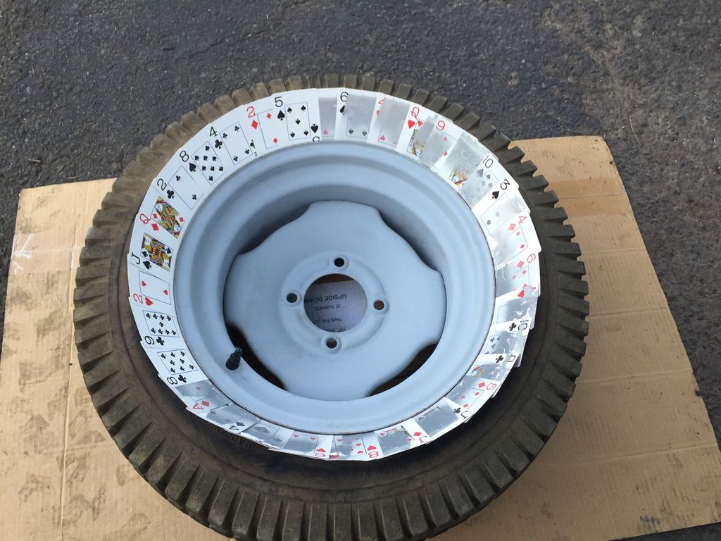

BigRedGrizzly 229 #41 Posted October 30, 2016 Hi Fellas.... I always seem to muck up the fresh paint on my rims with the tire irons when I go to remount them. So I started to use the playing card technique. 2 Share this post Link to post Share on other sites
Ed Kennell 46,608 #42 Posted October 30, 2016 Now that's one of the best ideas I have ever seen. 1 Share this post Link to post Share on other sites

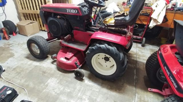

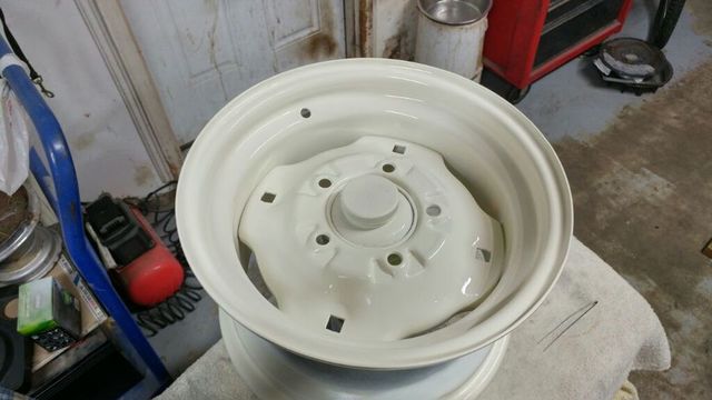

Duramax7man7 506 #44 Posted November 7, 2016 Alright. Here is the finished product. Not to bad. I like the canvas white for sure! Will be mounting the front lug tires and THEN painting them this time. I'll probably prep the rims first then mount the new ones. 2 Share this post Link to post Share on other sites

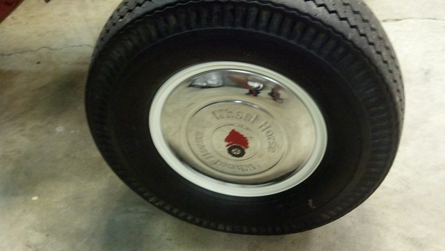

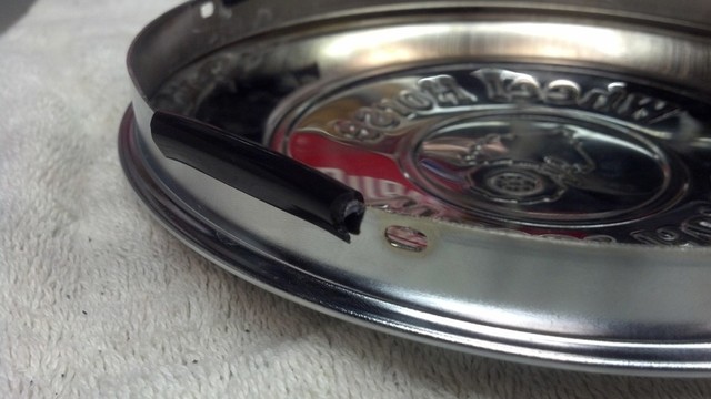

RedRanger 1,470 #45 Posted November 8, 2016 If you want to put those hubcaps back on without scratching the rims, a trick I found is to remove the clips on the hubcaps and run a strip of plastic door edge protector around the sharp edge of the hubcap and then install. The door edge guard will hold it in place just fine and not scratch the wheels. The plastic door edge makes a nice tight fit. 5 Share this post Link to post Share on other sites
Duramax7man7 506 #46 Posted November 8, 2016 Very cool. But I think that I like them better off. Otherwise I would have just not worried about the paint. But that's a GREAT Idea. Thanks for sharing. Andrew C. 1 Share this post Link to post Share on other sites
WheelHorseNut 222 #47 Posted November 8, 2016 On 10/30/2016 at 5:23 PM, BigRedGrizzly said: Hi Fellas.... I always seem to muck up the fresh paint on my rims with the tire irons when I go to remount them. So I started to use the playing card technique. Yup! I've used that on car wheels too -- but I used index cards. Same theory. A time saver for sure! 2 Share this post Link to post Share on other sites
Duramax7man7 506 #48 Posted November 8, 2016 Ah yes they would cover more too. Nice idea as well. Can't wait to try this on the front rims. Which are much cleaner than the rear ones were. They only have rust outside of the hubs. I also have lugs for the front rims. Share this post Link to post Share on other sites
WHX?? 57,461 #49 Posted November 8, 2016 Thanks Big Red for chiming in on that card trick, I saw that before here but couldn't find it! 1 Share this post Link to post Share on other sites
