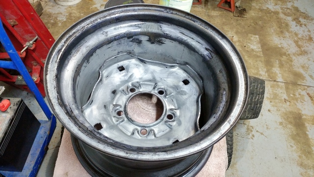

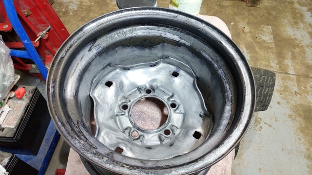

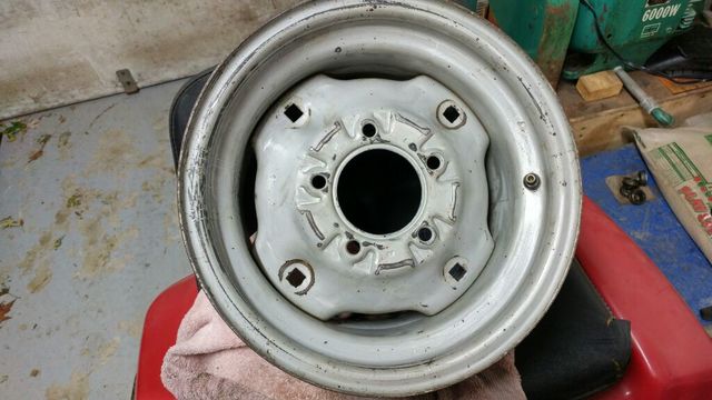

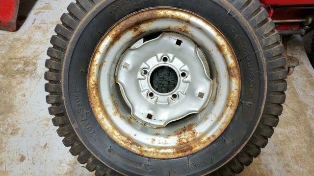

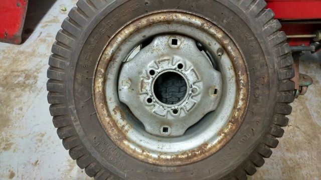

Duramax7man7 506 #15 Posted October 19, 2016 Primer. Better if self etching. Check! Okay. So I managed to get the rims off, cleaned and degreased. I wrestled one tire off spending most of the time on the beads. What a pain without any type of tire machine or bead breaker. I might have to pick one up. I will say though, the beads were tougher on this bigger rim but removing the tire was tougher on a 6" rim... Cant wait to slam a 6ply tire on this thing. :o/ I took a wire wheel to everything I could and 220 grit sandpaper to the rest. As I dont have a sand blaster or anything. Am I supposed to go down to bare metal? Here are before and after. I heard of a product that NAPA makes that deactivates (?) any left over rust and simultaneously primes the surface. Good idea or no. Share this post Link to post Share on other sites
RedRanger 1,470 #16 Posted October 19, 2016 (edited) As long as you get all the loose paint and rust off, you don't need to strip the entire wheel. I'd prime those with self etching primer and then a few coats of high build filler primer and sand between coats. Then paint. The filler primer will smooth it out a lot. I've had my rims sand blasted and powder coated. I'd replace the valve stems while you're at it too. Edited October 19, 2016 by RedRanger 2 Share this post Link to post Share on other sites
Achto 32,104 #17 Posted October 19, 2016 Also any rust left on the metal will come back to haunt you some day. Make sure the inside of the rim is cleaned up too. In my experience the inside of rims are some times rusted worse than the out sides. You won't see it once the tires on but it will eventually work its way through. 2 Share this post Link to post Share on other sites

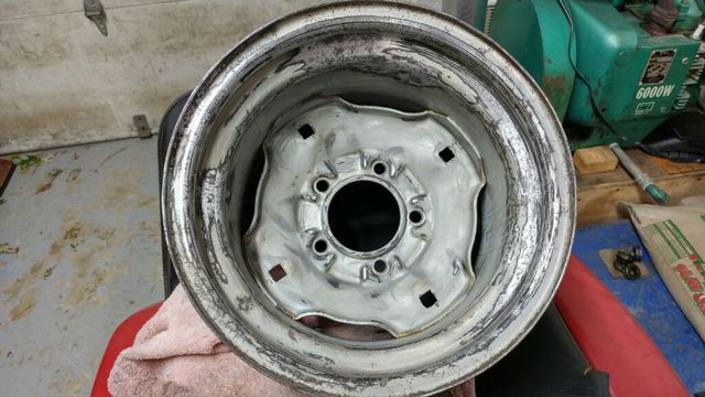

Duramax7man7 506 #24 Posted October 21, 2016 Thanks for Chimming in. I've been considering taking my white cans back and hunting down some off white as well. This was a little while after using the "Rust Fix" inhibitor/ primer. Share this post Link to post Share on other sites

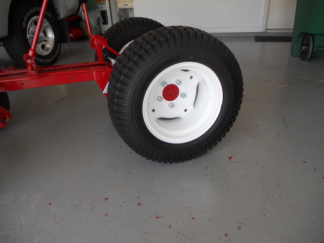

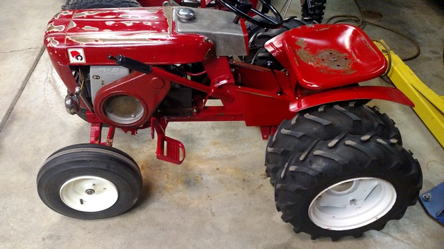

RedRanger 1,470 #25 Posted October 21, 2016 Those look good. Filler primer-sand-filler primer-sand-paint. They'll look great. Just for reference... These front rims are Canvas White. Rear rims are painted gloss white by the po. Canvas white looks real close to original. Some posts on here even state canvas white as the OE color. Not as dark as Antique, but a better looking color IMO. Share this post Link to post Share on other sites
