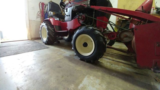

Duramax7man7 506 #80 Posted November 29, 2016 Yeah that's what I was concerned with most is the lifting of the blower... Even though I'm a good 200lbs @ 5' 10" (some say I'm dense!? ha ha) I still think that using rear weight will help out. I purchased a hitch from "The Hitch Guys" off the venders list about a week ago so I plan on using that first with an inverted hitch with a larger bolt secured through it and some cheap bar bell weights to slip over top of that and secured with a larger washer and nut. May a 100 or so pounds worth... We only have about 55' Driveway that is 2 cars wide but I also do both neighbors driveways on either side of me and if this setup works well enough I'll be hitting the corner where a street dead ends into ours. We have an undercover enforcement lab at an old elementary school down the street. SO our street gets plowed and that corner always gets destroyed with extra snow making it very difficult for neighbors to traverse it when needed. Here is the finished product for the caps.... Share this post Link to post Share on other sites
