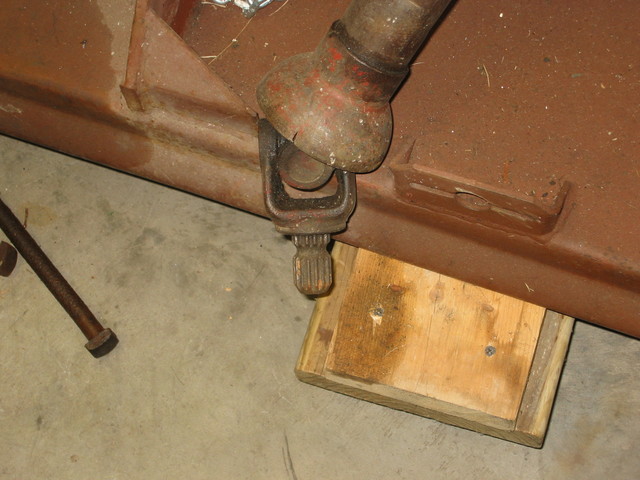

pfrederi 21,306 #5 Posted October 20, 2016 One more thing on farm tractor the PTO is Male...on the D series it is female. Picture is of eh PTO shaft for my 3pt finish mower that goes on the D Share this post Link to post Share on other sites
