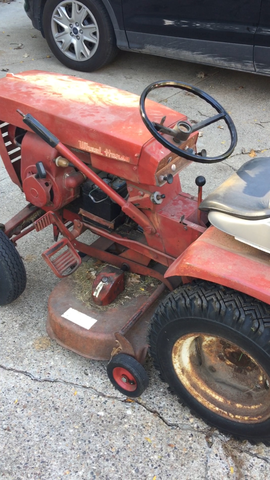

Bakerb9 14 #1 Posted October 18, 2016 It still needs work, but she runs. Going to try to figure out the plow attachment later this week. Hopefully over the winter I can track down the rest of the attachments that my wife's grandpa says he hasn't laying around in random storage units. 11 Share this post Link to post Share on other sites

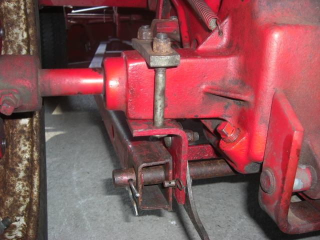

Retired Wrencher 7,037 #7 Posted October 18, 2016 (edited) Bakerb9 I just did mine can send pick if needed. Once you see how it attaches to implement lift the rest is easy. let me know if you would like picture to help. I have a 657 same tractor I use it all summer at the shows. All day on a tank of gas. you like it. Fine little tractor. Enjoy. Edited October 18, 2016 by T1257 RETIRED WRENCHER. Share this post Link to post Share on other sites

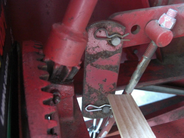

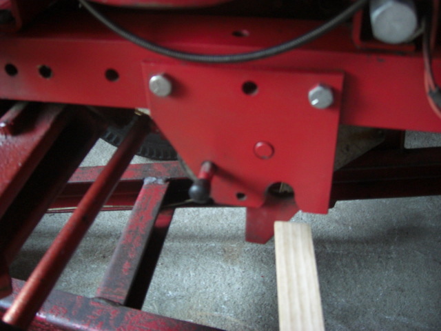

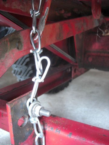

Retired Wrencher 7,037 #13 Posted October 18, 2016 Bakerb9 here are a few picks of what I was saying earlier about the hook up. look at the paint stir. the last pick is where the frame should sit up the front by the quick attach. 1 Share this post Link to post Share on other sites
TDF5G 2,074 #14 Posted October 18, 2016 (edited) You don't have that hooked up correctly. The small metal plate in your pic attaches between the lift bar and the dozer blade frame. Then you don't need the chain. I'll see if I can find a pic. I'm at work, can't take pics of my tractors. Your'e connected to the rear axle bracket correctly. Note: the dozer blade attachment does not utilize the mid mount tach-a-matic. Edited October 18, 2016 by TDF5G Share this post Link to post Share on other sites

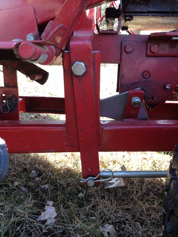

TDF5G 2,074 #15 Posted October 18, 2016 (edited) I got lucky and found a pic without too much hunting. Notice to the left of the pic how the little metal plate its attached with the pins and no chain needed. It hooks up to the front hole of the lift bar. Edited October 18, 2016 by TDF5G 3 Share this post Link to post Share on other sites
Retired Wrencher 7,037 #16 Posted October 18, 2016 well I am no expert but will take a look at it. Thanks. The lift handle set all the way down on adjustment? Share this post Link to post Share on other sites

TDF5G 2,074 #19 Posted October 18, 2016 1 hour ago, T1257 RETIRED WRENCHER. said: well I am no expert but will take a look at it. Thanks. The lift handle set all the way down on adjustment? You just need it low enough to hook it up. Then adjust as required for the job. 1 Share this post Link to post Share on other sites

Retired Wrencher 7,037 #23 Posted October 19, 2016 21 hours ago, TDF5G said: I got lucky and found a pic without too much hunting. Notice to the left of the pic how the little metal plate its attached with the pins and no chain needed. It hooks up to the front hole of the lift bar. Success. this what happens when you guess. I did not see that hole on the deck arm DUUUUUHHHH. 2 Share this post Link to post Share on other sites
TDF5G 2,074 #24 Posted October 19, 2016 1 hour ago, T1257 RETIRED WRENCHER. said: Success. this what happens when you guess. I did not see that hole on the deck arm DUUUUUHHHH. Now you're cookin' with Crisco! Those holes in the blade frame look a little worn. Nothing a little welding and a drill won't fix though! And now you have a spare piece of chain to use on something else. 1 Share this post Link to post Share on other sites
Retired Wrencher 7,037 #25 Posted October 19, 2016 1 hour ago, TDF5G said: Now you're cookin' with Crisco! Those holes in the blade frame look a little worn. Nothing a little welding and a drill won't fix though! And now you have a spare piece of chain to use on something else. I will not be using much. I do not have a welder. Maybe use a 3/8 with a lock nut on it to hold If need be. 1 Share this post Link to post Share on other sites
