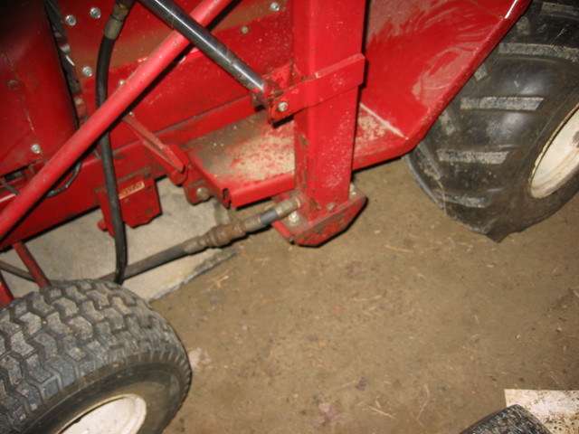

pfrederi 21,055 #14 Posted December 7, 2016 The line out of the bottom of the loader frame feeds the pump. Inside the upright (reservoir) is an mesh screen leading into this hose.. Bad news you have to drain the reservoir to get at it (I assume this is an Arc 500 loader Share this post Link to post Share on other sites

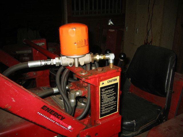

pfrederi 21,055 #16 Posted December 7, 2016 (edited) Screen is inside the upright at the bottom in the picture. Also I would install a real filter on the bypass line out of the control valve to the top of the reservoir. Please no comments about the plumbing of the filter I used what I had lying around Edited December 7, 2016 by pfrederi 1 Share this post Link to post Share on other sites
