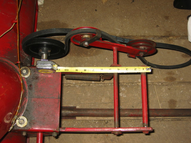

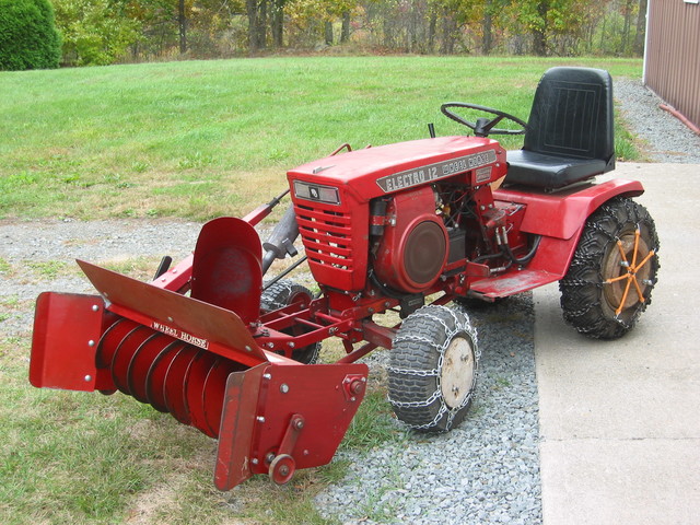

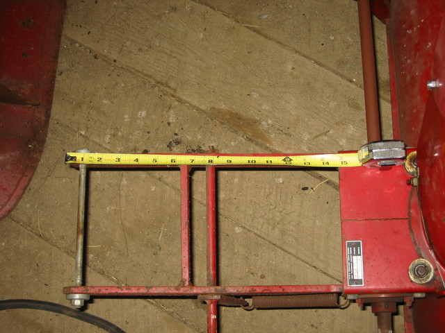

pfrederi 21,234 #2 Posted October 18, 2016 Has Front Tachmatic ever been added to your Charger?? Here is the issue. The blower you have was designed to be used on older tractors that didn't have a front tachmatic. The mounting frame had a Long bolt at the end that actually went through the front holes on each side of the tractor frame. (it would be in the frame hole directly above the axle the one with the first bolt on my front tachmatic mount. If the tractor had a front tachmatic a shorter mounting frame would be needed as the pivot point is out in front of the tractor not in the tractor frame itself. The longer mount in the picture is what you need if you do not have a front tachmatic as it will bolt directly to eh front holes on the tractor frame. The shorter frame in the other picture would be used if you have the tachmatic. I would hazard a guess a PO cut down teh long mount to use it on a front tachmatic tractor. In the first picture you can see my Electro (Charger). I added the bolt on front tachmatic so I use the shorter frame. I f you could round up one of those that might be another solution for you. 1 Share this post Link to post Share on other sites

pfrederi 21,234 #4 Posted October 18, 2016 (edited) Steve: i am not sure about that. Each time I move a blower to another tractor I have to add or delete a bunch of washers between the flag and the lift pipe. I would think the lift mechanism would be about the same length. The extra 4 inches on the old system is taken up passing where the front tachmatic would have been and the first bolt hole in the frame. Just went and measured it is 4 inches from the pivot point of a front Tachmatic to the first hole in the frame Edited October 18, 2016 by pfrederi 1 Share this post Link to post Share on other sites
