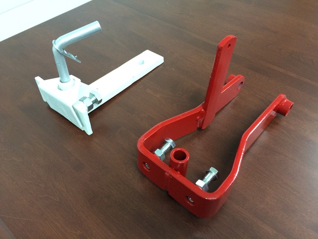

Achto 32,845 #4 Posted October 18, 2016 Sorry I missed that one was a 64 Lawn Ranger, I would not suggest that one either. These are the two types of Brinly hitches that I was describing for you tractor. Either one of these hitches will allow you to attach most Brinly brand name implements to your tractor. Brinly also made a plow for , if you find one of these it will be made to slide into the slot hitch on your tractor. 2 Share this post Link to post Share on other sites
